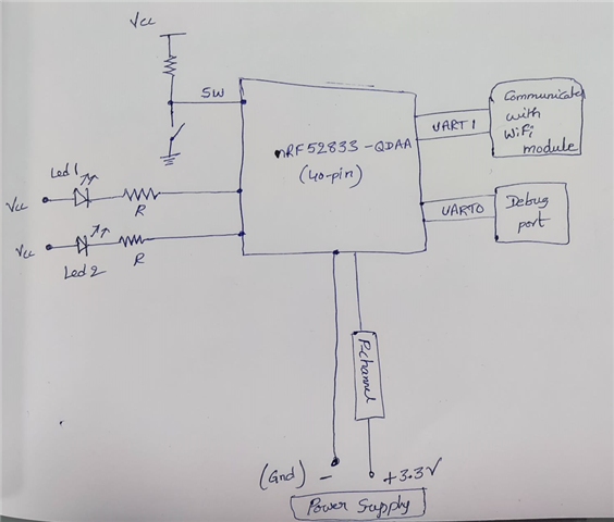

    - There are 2 active UARTs in my application. Will they go into sleep in both the sleep modes? or do we need to make the UARTs sleep while entering into the sleep mode? Please advise.
    I am just sharing my application block diagram for your reference.
  • The reason why you see the peripheral_uart drawing more power is probably due to the UART being left on. It requires the HFCLK to run, which is why you see that increased current consumption.
    To enter system off mode, you can use either the native nRF API: NVIC_Systemoff(); or you can use Zephyr's: sys_poweroff();
    Indeed, UARTs are power hungry, so if you want to conserve energy, you would need to disable them. This is to make the HFCLK stop when you enter system on mode. This will however mean that you don't have the possibility to receive UART messages while these are disabled.
    To disable the UART you can use
    pm_device_action_run(uart_dev, PM_DEVICE_ACTION_SUSPEND);
    as described here:
     Problems putting UART into PM_DEVICE_ACTION_SUSPEND
    Vivek_P said:
    Is this k_sleep() alone can help in achieving the best sleep currents?
    This in itself should be sufficient, but please use this as a default in all your threads (if you have several). If one thread is stuck in a while(true) loop then it will not enter system off. Using k_fifo_get() like it is done in one of the threads in the peripheral_uart sample is also fine. It will enter system on mode until this is given.

  • How do you measure the current? Do you have a PPK2?
    It's not that easy to follow from your code, but when you are seeing ~22µA, what is turned on then? I believe you have turned off your UART, but what about other peripherals? Are they turned on? And are you running the RTC at this point in time? What is your LFCLK source? LFXTAL or RC Oscillator? What hardware are you running on? an nRF52833 DK or custom HW?
    How about the GPIOs that you set as output? Are they still output pins when you go to sleep?
    BR,
    Edvin
