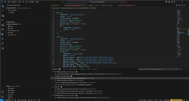

  • I'm trying configure the UART0.  Where can I go to understand how to create a UART node. I've gone through the first of the of the dev academy, but it doesn't seem to address this.  I have a simple HMI with TX and RX, no flow-control that I need to connect to UART0.  Trying to add it to the DTS overlay, but get the "Only uart nodes accepted in /soc/uart@40002000/." error.
