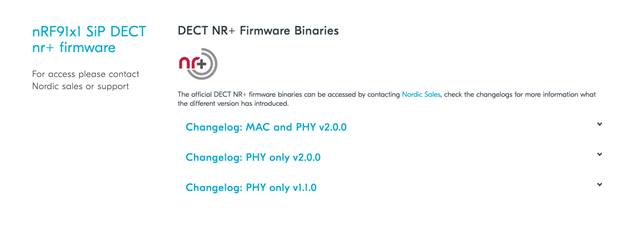

Secondly, , there's a binary demo you're providing for the nrf9161 with a Mosh shell and a "dect" command that implements, among other things, a (partial?) MAC layer. Will this source code become public, or be provided as a library?
