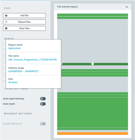

I am using Bluetooth for DFU in NCS version 2.6.1, but I encountered an issue in Device Manager that says, "There is no free slot to place the image." In the JLINK RTT, I received the following information:

    Could it be that the old image is still present in the other slot? I see that your screenshot says "Swap type: revert". Does that mean that if you program your first application using the programmer/debugger, then perform the DFU one time, and then power cycle your device. Is it the first application and the second application that boots up then?

  • I performed the DFU using the "Test only" option, and here’s the sequence of operations I followed:
    1. I used JLINK to completely erase the FLASH and burn the latest firmware. This version prints ("Helloworld 0001\n") when running (Flash was successful).
    2. I then modified the print statement to ("Helloworld 0002\n"), rebuilt the firmware, and updated it using build_1/zephyr/dfu_application.zip (DFU was successful).
    3. After modifying the code again to ("Helloworld 0003\n"), I encountered the initial error: "There is no free slot to place the image," along with the JLINK output.
  • Try to power cycle it after step 2, and monitor the log. Does it say "Helloworld 0002" or "Helloworld 0001"?
