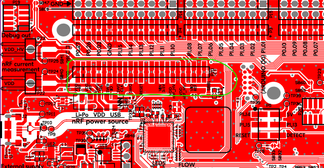

 We successfully used the nrf52840DK v.2.0.1 as programming tool for a custom board, the wiring was as depicted here:
 https://devzone.nordicsemi.com/f/nordic-q-a/84893/programming-a-custom-board-with-an-nrf52840-dev-kit
 Now, with new</description><dc:language>en-US</dc:language><generator>Telligent Community 13</generator><lastBuildDate>Tue, 13 Jun 2023 11:33:20 GMT</lastBuildDate><atom:link rel="self" type="application/rss+xml" href="https://devzone.nordicsemi.com/f/nordic-q-a/100747/nrf52840-dk-hw-rev-3-0-1-gpio-programming-pins" /><item><title>RE: nrf52840 DK HW rev 3.0.1 GPIO Programming PINs</title><link>https://devzone.nordicsemi.com/thread/430717?ContentTypeID=1</link><pubDate>Tue, 13 Jun 2023 11:33:20 GMT</pubDate><guid isPermaLink="false">137ad170-7792-4731-bb38-c0d22fbe4515:bbc750f4-888f-49ed-bcdd-62d1b727fc67</guid><dc:creator>Priyanka</dc:creator><description>&lt;p&gt;Hi Richard,&lt;/p&gt;
&lt;p&gt;In the new revision, the VTG had been renamed to SWD_SEL.&lt;/p&gt;
&lt;p&gt;&lt;img style="max-height:240px;max-width:320px;" src="https://devzone.nordicsemi.com/resized-image/__size/640x480/__key/communityserver-discussions-components-files/4/pastedimage1686655924998v1.png" alt=" " /&gt;&lt;/p&gt;
&lt;p&gt;You just need to&amp;nbsp;&lt;span&gt;&lt;span dir="ltr"&gt;pull SWD_SEL to VDD, this enables debug/programming out on P20.&amp;nbsp;Also the usual SWD_IO and SWD_CLK connections need to be done along with a direct GND connection between both the boards.&lt;/span&gt;&lt;/span&gt;&lt;/p&gt;
