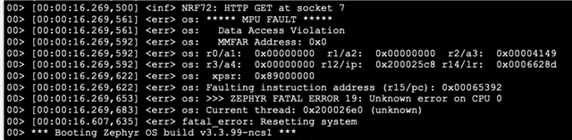

Hi there, I am working on setting up a HTTPS GET request with TLS credentials on the nrf7002dk. I am getting MPU Fault and Data Access Violation whenever I try to send packet to the server, I've tried to tune the memory sizes in prj.conf (didn't work, could have missed something there...), so I decided to step-through debug and see what went wrong. However, when I let the code run, it would always stop at the line shown in the attached image. I'm not really sure why this is happening, the debugger was working fine before, and I would really appreciate some help on its cause! Thank you for reading and offering any help if possible, have a fabulous day! Slight smile

  • Hi Dejans, thank you for replying! Yes, I can elaborate, sorry if my post description was vague. It is based on nrf's https_client example, desired behavior is sending a HTTPS request to a website and receiving response from it. I am using google.com and we intend to eventually use our own server. To elaborate on setting up the GET request, please the code block here, assuming that we have made connection to WiFi:

    What I meant by "the debugger was working fine before" was, there were a couple times when I am able to step through line by line till the fault happens, but when I try to debug again, the debugger gets stuck at log_core.c

  • Hi dejans, sorry for replying late, I am on 2.4.0 NCS. I recently changed my device tree files for nrf7002dk so I couldn't get the code running on my setup, but I used my colleague's machine and got the following output (took out some network info that shouldn't be important):

    00> [00:00:10.452,453] <err> os: ***** USAGE FAULT *****
    00> [00:00:10.452,484] <err> os:   Unaligned memory access
    00> [00:00:10.452,484] <err> os: r0/a1:  0x00000000  r1/a2:  0xffffffff  r2/a3:  0x00000000
    00> [00:00:10.452,514] <err> os: r3/a4:  0x200689c8 r12/ip:  0x20001a10 r14/lr:  0x0003ba21
    00> [00:00:10.452,514] <err> os:  xpsr:  0x69000000
    00> [00:00:10.452,514] <err> os: Faulting instruction address (r15/pc): 0x00002a96
    00> [00:00:10.452,545] <err> os: >>> ZEPHYR FATAL ERROR 31: Unknown error on CPU 0
    00> [00:00:10.452,575] <err> os: Current thread: 0x200022b0 (unknown)
    00> [00:00:10.735,534] <err> fatal_error: Resetting system

    Usually when I step through the code using the debugger, it enters the log_core.c before the breakpoint where the memory fault happens.
