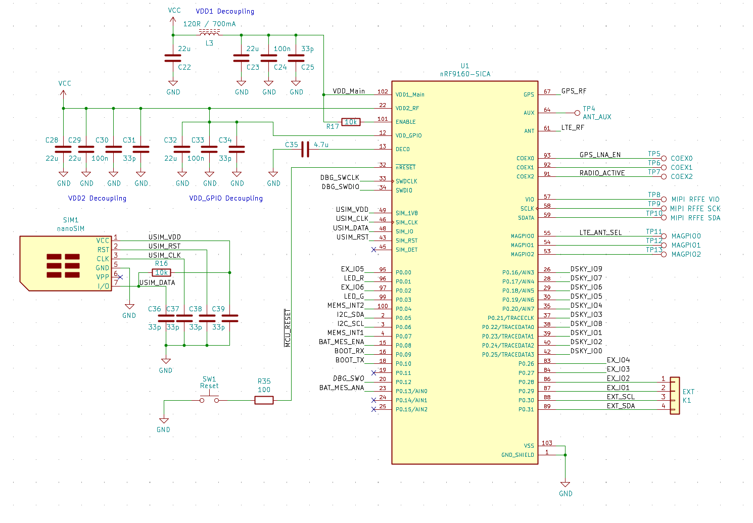

We have designed and built a battery-powered 'IoT' measurement device, based on the nRF9160 (SICA-B1A, MFW v1.3.3), currently in prototype field-testing phase.
The application is developed in Rust (all our green-field embedded development is done in Rust from 2019 onward) and the application functionally nearly finished. One of the things we're still chasing is the high idle use of the device, measuring ~1.7mA in the MCU power domain. We have been working quite hard to tackle this, but haven't found the culprit yet.
In order to eliminate any parasitic power use of the hardware components in our product, we ended up making a custom board that the is only populated with the nRF9160, a couple of decoupling caps and a SIM slot (no DC/DC psu, no sensors etc..) The goal is to have a "nothing" application, doing nothing expect having an "application" running with the lowest power possible to set the baseline power usage target for when all peripherals are connected in a fully populated/functional product.
When we run the nRF9160 with a 'hello world' type application the power use is (static, flat) 2.7mA @3.3V (the program ends in a WFI(), so CPU should be idle). We tried disabling as much MCU peripherals as possible, with no result: draw remains a steady 2.7mA. What we did find is, that when the modem is initialized, but not enabled (calling `nrf_modem_init` in the nrfxlib), the power use drops by about 1 mA (to 1.7mA). Still way too high, but better... unexpected(!), but better..
Although there's next-to-nothing on our board, we started to doubt our purpose-created hardware; how can it be that a bare-as-bone hardware and software is still drawing a whopping 2.7 mA's.. there has to be something wrong with the hardware.. But lo and behold when we flashed a 'do nothing' (single `printk` in the `main()`) sample using the Zephyr based connect SDK, the power use dropped to 4µA.. that's more like it! (in our final product anything <50µA idle use would be acceptable). At least now we know our hardware is capable of a very low power usage. We fruitlessly invested another couple of hours trying to find what is the culprit, no smoking gun was found why we weren't able to get to this level in our programming environment.

For completeness the (part of the) schematics which was is populated on the board:
/resized-image/__size/2080x2070/__key/communityserver-discussions-components-files/4/pastedimage1693836927606v3.png

  • Hi Helsing,
    Thanks for getting back! Yes indeed, I got in contact with the very helpful local Application Engineer. I had a nice conversation with him, but unfortunately this didn't materialize into concrete pointers to the issue at hand. (The FAE will be forwarding me some additional information/pointers regarding the issue).
    In the mean time I did some more "fiddling" and got the power down to 1.2mA, not a huge improvement, but nevertheless an improvement. This was the result of disabling the DC/DC converter on the SoC. (peripherals.REGULATORS_NS.dcdcen.write(|w| w.dcdcen().disabled()))

  • Ok.. I knew it had to be something trivial...
    I think I have found the leak; somewhere hidden in my code I had the line:
    core::ptr::write_volatile(0x4000_5C04 as *mut u32, 0x02);
    Which is a mitigation for anomaly [17] Debug and Trace: LTE modem stops when debugging through SWD interface This erratum has been long-fixed in the production hardware revisions, so is never needed anymore. Face palm
    Anyway, the mystery seems solved, so very happy with that. :) Now we can properly power-optimize the design further.
