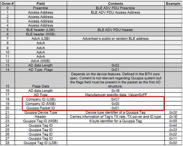

 If the advertising packet of the AoA tag is structured like the screenshot below, can the Nordic&amp;#39;s direction finding locator filter out the target tag by the information circled by the red box in the below screenshot and the user can</description><dc:language>en-US</dc:language><generator>Telligent Community 13</generator><lastBuildDate>Wed, 28 Feb 2024 08:51:44 GMT</lastBuildDate><atom:link rel="self" type="application/rss+xml" href="https://devzone.nordicsemi.com/f/nordic-q-a/108542/how-to-filter-out-the-target-aoa-tag" /><item><title>RE: How to filter out the target AoA tag</title><link>https://devzone.nordicsemi.com/thread/471212?ContentTypeID=1</link><pubDate>Wed, 28 Feb 2024 08:51:44 GMT</pubDate><guid isPermaLink="false">137ad170-7792-4731-bb38-c0d22fbe4515:a9726696-7f76-490c-8e51-9e005977a340</guid><dc:creator>Simonr</dc:creator><description>&lt;p&gt;Hi&lt;/p&gt;

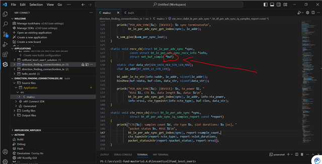

&lt;p&gt;Yes, the advertising data is stored in this buffer if I&amp;#39;m not mistaken. Regarding the advertising packet, that&amp;#39;s not how Direction finding packets are working I&amp;#39;m afraid. In the Bluetooth solution of Direction Finding, the advertiser and receiver will agree on synchronized advertising, that will then allow the advertiser to send a continuous tone extension with the Direction Finding data that the receiver will receive as IQ data. Once received, the receiver will need to convert this raw IQ data into vector form to be reviewed correctly.&amp;nbsp;&lt;/p&gt;

&lt;p&gt;&lt;span&gt;Is the payload section of the received advertisement stored in buffer the below screenshot refer to?&lt;/span&gt;&lt;/p&gt;
&lt;p&gt;&lt;span&gt;&lt;img style="max-height:240px;max-width:320px;" alt=" " src="https://devzone.nordicsemi.com/resized-image/__size/640x480/__key/communityserver-discussions-components-files/4/pastedimage1709003763174v1.png" /&gt;&lt;/span&gt;&lt;/p&gt;

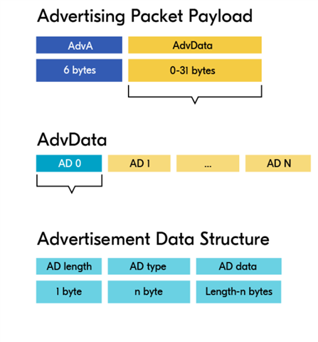

&lt;p&gt;&lt;span&gt; And the payload is also structured like the screenshot below? if so, could I get the&amp;nbsp;information circled by the red box in the previous screenshot for the target tag filtering?&lt;/span&gt;&lt;/p&gt;
&lt;p&gt;&lt;span&gt;&lt;img style="max-height:240px;max-width:320px;" alt=" " src="https://devzone.nordicsemi.com/resized-image/__size/640x480/__key/communityserver-discussions-components-files/4/pastedimage1709004224187v2.png" /&gt;&lt;/span&gt;&lt;/p&gt;

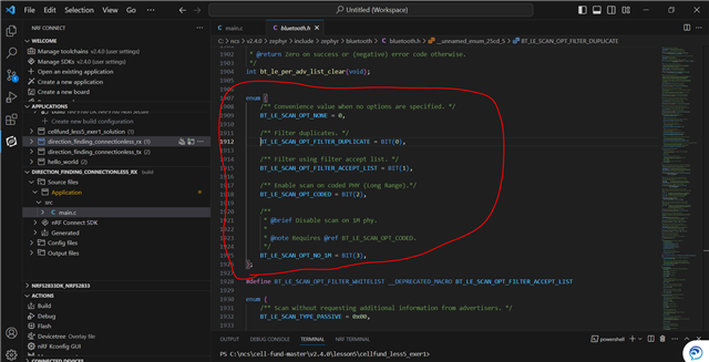

&lt;p&gt;&lt;span&gt;I find that there&amp;#39;s some filter option provided in the code, does these options must be considered if use the filter on the application layer mentioned above?&lt;/span&gt;&lt;/p&gt;
&lt;p&gt;&lt;span&gt;&lt;img style="max-height:240px;max-width:320px;" alt=" " src="https://devzone.nordicsemi.com/resized-image/__size/640x480/__key/communityserver-discussions-components-files/4/pastedimage1709005120689v3.png" /&gt;&lt;/span&gt;&lt;/p&gt;

&lt;p&gt;The format you refer to seems like the format &lt;a href="https://www.quuppa.com/"&gt;Quuppa &lt;/a&gt;uses. Since they use a proprietary solution for Direction Finding, we don&amp;#39;t think this AoA packet format will be compatible with our receiver code. Since the data you refer to here is in the payload section, the filtering must be done on the application layer here, something the Bluetooth compliant AoA solution does on a lower level, so I&amp;#39;m afraid this will not be straight forward. You can try contacting Quuppa about this, but I&amp;#39;m not sure you&amp;#39;ll be able to get anywhere.&lt;/p&gt;
