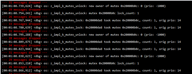

<?xml-stylesheet type="text/xsl" href="https://devzone.nordicsemi.com/cfs-file/__key/system/syndication/rss.xsl" media="screen"?><rss version="2.0" xmlns:dc="http://purl.org/dc/elements/1.1/" xmlns:slash="http://purl.org/rss/1.0/modules/slash/" xmlns:wfw="http://wellformedweb.org/CommentAPI/" xmlns:atom="http://www.w3.org/2005/Atom"><channel><title /><link>https://devzone.nordicsemi.com/f/nordic-q-a/115922/thread</link><description>This information is printed all the time while the debug is running at full speed What is the reason for this?
 If it is not debug, the program runs normally</description><dc:language>en-US</dc:language><generator>Telligent Community 13</generator><lastBuildDate>Tue, 29 Oct 2024 10:00:46 GMT</lastBuildDate><atom:link rel="self" type="application/rss+xml" href="https://devzone.nordicsemi.com/f/nordic-q-a/115922/thread" /><item><title>RE:</title><link>https://devzone.nordicsemi.com/thread/508316?ContentTypeID=1</link><pubDate>Tue, 29 Oct 2024 10:00:46 GMT</pubDate><guid isPermaLink="false">137ad170-7792-4731-bb38-c0d22fbe4515:c8e2bd3b-7b6c-4296-b082-6e1b033870b2</guid><dc:creator>H&amp;#229;kon Alseth</dc:creator><description>&lt;p&gt;Hi,&lt;/p&gt;

&lt;p&gt;When using the LOG module in a deferred mode, ie. that log messages are processed in a lower priority state, you can get a log buffer overflow if there&amp;#39;s too many queued items.&lt;/p&gt;
&lt;p&gt;Try adjusting the log buffer via CONFIG_LOG_BUFFER_SIZE=8192 for instance.&lt;/p&gt;
