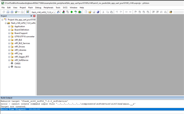

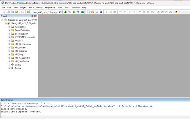

&lt;p&gt;&lt;span&gt;I have first reviewed my mistakes. I have tried all the methods obtained from the search results of the large language model, and also deployed the development environment accordingly. However, I still cannot solve this problem.&lt;/span&gt;&lt;/p&gt;&lt;div style="clear:both;"&gt;&lt;/div&gt;</description></item><item><title>RE: 环境搭建</title><link>https://devzone.nordicsemi.com/thread/551198?ContentTypeID=1</link><pubDate>Sun, 12 Oct 2025 03:56:53 GMT</pubDate><guid isPermaLink="false">137ad170-7792-4731-bb38-c0d22fbe4515:c3f32a17-74cc-4f55-8c06-5d59b4650edf</guid><dc:creator>wt1</dc:creator><description>&lt;p&gt;&lt;span&gt;If possible, I hope you can take control of my computer to help me solve the environment configuration problem.&lt;/span&gt;&lt;/p&gt;&lt;div style="clear:both;"&gt;&lt;/div&gt;</description></item><item><title>RE: 环境搭建</title><link>https://devzone.nordicsemi.com/thread/551197?ContentTypeID=1</link><pubDate>Sun, 12 Oct 2025 03:54:37 GMT</pubDate><guid isPermaLink="false">137ad170-7792-4731-bb38-c0d22fbe4515:7cefc780-5a64-49a3-b198-3a3c2004bfab</guid><dc:creator>wt1</dc:creator><description>&lt;p&gt;Hello,&lt;span&gt;&amp;nbsp;when I was deploying the environment in the software you provided and installing the GNU Arm Embedded Toolchain, I asked AI about it. It told me that I needed a file named ccl. However, I downloaded the latest version from Arm, but there was no such file in its bin directory. Re-downloading it multiple times didn&amp;#39;t solve this problem either.&lt;/span&gt;&lt;/p&gt;&lt;div style="clear:both;"&gt;&lt;/div&gt;</description></item><item><title>RE: 环境搭建</title><link>https://devzone.nordicsemi.com/thread/551078?ContentTypeID=1</link><pubDate>Fri, 10 Oct 2025 06:41:34 GMT</pubDate><guid isPermaLink="false">137ad170-7792-4731-bb38-c0d22fbe4515:65921c40-1df4-496e-a69c-edad93084e2e</guid><dc:creator>Simonr</dc:creator><description>&lt;p&gt;Hi&lt;/p&gt;
&lt;p&gt;On the nRF52833 DK there is already a J-Link debugger MCU on the board that lets you program and debug the nRF52833 on the DK.&lt;/p&gt;
&lt;p&gt;Best regards,&lt;/p&gt;
&lt;p&gt;Simon&lt;/p&gt;&lt;div style="clear:both;"&gt;&lt;/div&gt;</description></item><item><title>RE: 环境搭建</title><link>https://devzone.nordicsemi.com/thread/551012?ContentTypeID=1</link><pubDate>Thu, 09 Oct 2025 12:34:47 GMT</pubDate><guid isPermaLink="false">137ad170-7792-4731-bb38-c0d22fbe4515:95273302-5e3f-47ab-bcf2-b323d9077f03</guid><dc:creator>wt1</dc:creator><description>&lt;p&gt;&lt;span&gt;Hello, I would like to ask if a J - Link debugger must be used when SEGGER Embedded Studio is used for software development related to the nrf52833dk.&lt;/span&gt;&lt;/p&gt;&lt;div style="clear:both;"&gt;&lt;/div&gt;</description></item><item><title>RE: 环境搭建</title><link>https://devzone.nordicsemi.com/thread/549889?ContentTypeID=1</link><pubDate>Fri, 26 Sep 2025 11:00:58 GMT</pubDate><guid isPermaLink="false">137ad170-7792-4731-bb38-c0d22fbe4515:39e0414a-43bb-42a5-8d42-506868ec1ef4</guid><dc:creator>wt1</dc:creator><description>&lt;p&gt;&lt;strong&gt;Thank you very much&lt;/strong&gt;&lt;/p&gt;&lt;div style="clear:both;"&gt;&lt;/div&gt;</description></item><item><title>RE: 环境搭建</title><link>https://devzone.nordicsemi.com/thread/549864?ContentTypeID=1</link><pubDate>Fri, 26 Sep 2025 07:48:52 GMT</pubDate><guid isPermaLink="false">137ad170-7792-4731-bb38-c0d22fbe4515:0e3e0eb8-93f4-4777-833a-603df8a6b9cf</guid><dc:creator>Simonr</dc:creator><description>&lt;p&gt;Hi&lt;/p&gt;
&lt;p&gt;It seems like you&amp;#39;re trying to build/rebuild the SoftDevice itself, which shouldn&amp;#39;t be necessary. You should build the application and not the SoftDevice component. Then flash the .hex for both onto your board. Either with Keil, SEGGER Embedded Studio or the &lt;a href="https://www.nordicsemi.com/Products/Development-tools/nRF-Connect-for-Desktop"&gt;nRF Connect for Desktop&lt;/a&gt; Programmer application.&lt;/p&gt;
&lt;p&gt;Note that we recommend using &lt;a href="https://www.segger.com/products/development-tools/embedded-studio/"&gt;SEGGER Embedded Studios&lt;/a&gt; for developing nRF5 SDK projects. You get a license by owning an nRF52 series device and is generally easier to get started with than Keil µVision and the nRF5 SDK in my opinion.&lt;/p&gt;
