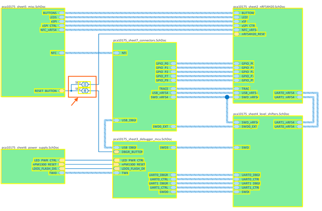

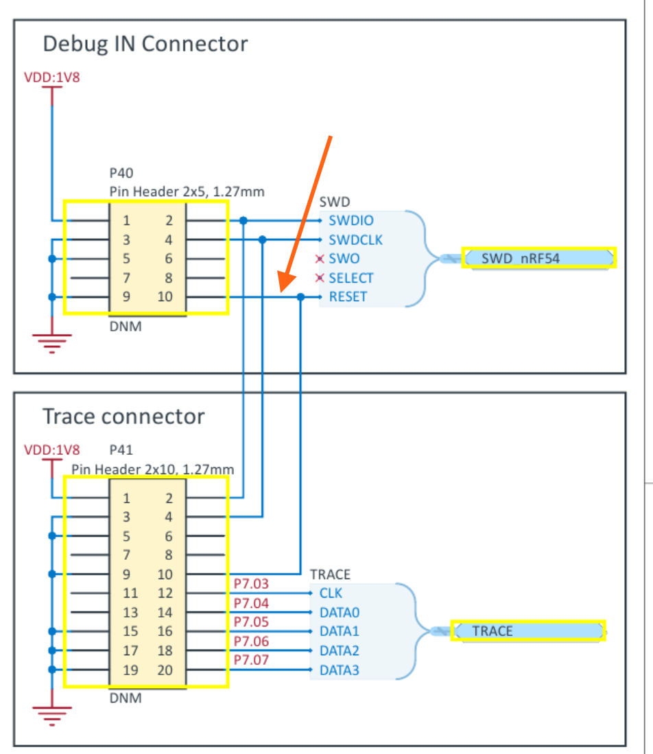

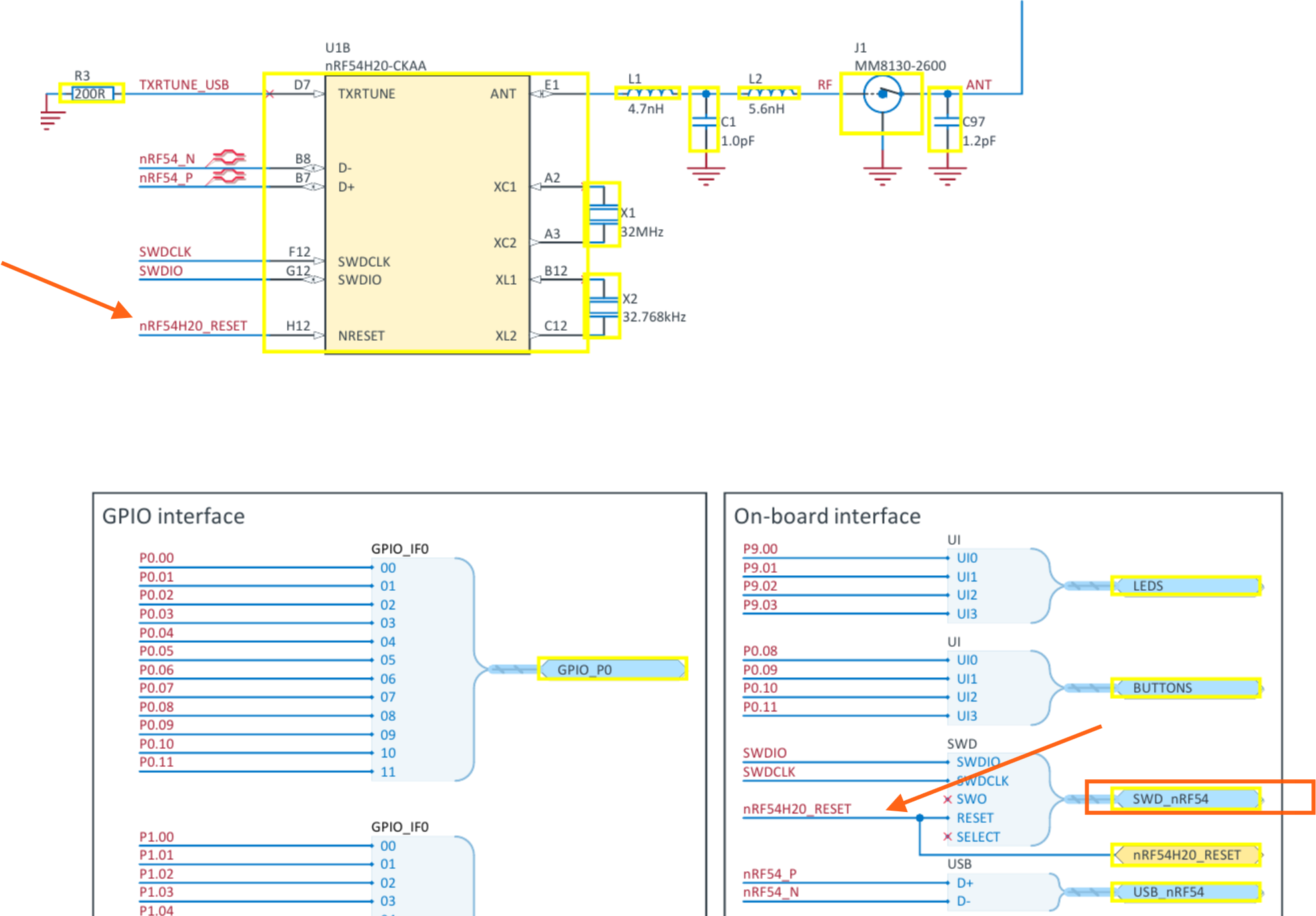

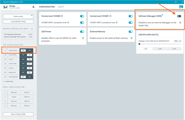

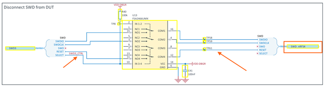

<?xml-stylesheet type="text/xsl" href="https://devzone.nordicsemi.com/cfs-file/__key/system/syndication/rss.xsl" media="screen"?><rss version="2.0" xmlns:dc="http://purl.org/dc/elements/1.1/" xmlns:slash="http://purl.org/rss/1.0/modules/slash/" xmlns:wfw="http://wellformedweb.org/CommentAPI/" xmlns:atom="http://www.w3.org/2005/Atom"><channel><title>External HW reset of the nRF54H20DK</title><link>https://devzone.nordicsemi.com/f/nordic-q-a/128871/external-hw-reset-of-the-nrf54h20dk</link><description>We have nRF54H20 with IRONSIDE (SDK3.2.4).
 RESET button has default configuration - connected to DEBUG MCU:
 We need realize external HW reset of the DK by another MCU (Raspberry Pi5). We are using virtual open drain configuration due to different</description><dc:language>en-US</dc:language><generator>Telligent Community 13</generator><lastBuildDate>Tue, 04 Aug 2026 13:15:22 GMT</lastBuildDate><atom:link rel="self" type="application/rss+xml" href="https://devzone.nordicsemi.com/f/nordic-q-a/128871/external-hw-reset-of-the-nrf54h20dk" /><item><title>RE: External HW reset of the nRF54H20DK</title><link>https://devzone.nordicsemi.com/thread/569874?ContentTypeID=1</link><pubDate>Tue, 04 Aug 2026 13:15:22 GMT</pubDate><guid isPermaLink="false">137ad170-7792-4731-bb38-c0d22fbe4515:29cbb1ba-c173-4e24-a7d4-eaa325daf7ed</guid><dc:creator>Peter Langer Keysoft</dc:creator><description>&lt;p&gt;We&amp;nbsp;have already found the mistake.&lt;/p&gt;
