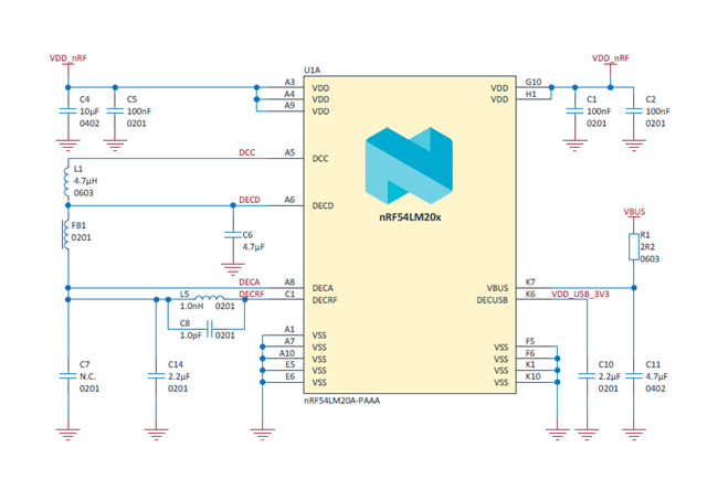

 In the NRF54LM20A Development Kit, in addition to the tank circuit (L5 + C8) in the path between DECA and DECRF, there is also a filter made from C7=2.2uF and FB2=15nH.
 However, in the NRF54LM20A datasheet FB2 is removed and C7 is not populated</description><dc:language>en-US</dc:language><generator>Telligent Community 13</generator><lastBuildDate>Thu, 27 Aug 2026 12:18:27 GMT</lastBuildDate><atom:link rel="self" type="application/rss+xml" href="https://devzone.nordicsemi.com/f/nordic-q-a/129043/nrf54lm20a-decrf-hardware-reference" /><item><title>RE: NRF54LM20A DECRF hardware reference</title><link>https://devzone.nordicsemi.com/thread/570665?ContentTypeID=1</link><pubDate>Thu, 27 Aug 2026 12:18:27 GMT</pubDate><guid isPermaLink="false">137ad170-7792-4731-bb38-c0d22fbe4515:85179ce7-870c-4221-b5b8-7fb617c21d59</guid><dc:creator>Ressa</dc:creator><description>&lt;p&gt;Hi,&lt;br /&gt;&lt;br /&gt;It is recommended to follow latest reference design files for new designs:&lt;br /&gt;&lt;a href="https://nsscprodmedia.blob.core.windows.net/prod/software-and-other-downloads/reference-layouts/nrf54lm20a/nrf54lm20_paaa-reference-layout-0_6.zip"&gt;https://nsscprodmedia.blob.core.windows.net/prod/software-and-other-downloads/reference-layouts/nrf54lm20a/nrf54lm20_paaa-reference-layout-0_6.zip&lt;/a&gt;&lt;br /&gt;&lt;br /&gt;&lt;br /&gt;v0.6 :&lt;br /&gt;&lt;img style="max-height:240px;max-width:320px;" src="https://devzone.nordicsemi.com/resized-image/__size/640x480/__key/communityserver-discussions-components-files/4/pastedimage1787833005154v1.png" alt=" " /&gt;&lt;br /&gt;&lt;br /&gt;&lt;/p&gt;&lt;div style="clear:both;"&gt;&lt;/div&gt;</description></item></channel></rss>
