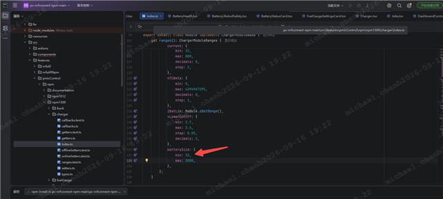

 Our project has chosen nPM1300 as the PMIC, and our project&amp;#39;s battery is only 28 mAh. When we tested the battery configuration file using the nPM PowerUP app, we found that the lower limit of the battery was 32 mAh.
 We obtained the source code</description><dc:language>en-US</dc:language><generator>Telligent Community 13</generator><lastBuildDate>Fri, 25 Sep 2026 06:45:09 GMT</lastBuildDate><atom:link rel="self" type="application/rss+xml" href="https://devzone.nordicsemi.com/f/nordic-q-a/129195/how-to-modify-the-source-code-of-npm-powerup-application-to-reduce-the-lower-limit-of-battery-capacity" /><item><title>RE: How to modify the source code of nPM PowerUP application to reduce the lower limit of battery capacity?</title><link>https://devzone.nordicsemi.com/thread/571580?ContentTypeID=1</link><pubDate>Fri, 25 Sep 2026 06:45:09 GMT</pubDate><guid isPermaLink="false">137ad170-7792-4731-bb38-c0d22fbe4515:c39ef1ce-e817-49f8-9b59-766d62ea9e6a</guid><dc:creator>Kazi Afroza Sultana</dc:creator><description>&lt;p&gt;You are welcome. &lt;span class="emoticon" data-url="https://devzone.nordicsemi.com/cfs-file/__key/system/emoji/1f642.svg" title="Slight smile"&gt;&amp;#x1f642;&lt;/span&gt;&lt;/p&gt;&lt;div style="clear:both;"&gt;&lt;/div&gt;</description></item><item><title>RE: How to modify the source code of nPM PowerUP application to reduce the lower limit of battery capacity?</title><link>https://devzone.nordicsemi.com/thread/571512?ContentTypeID=1</link><pubDate>Thu, 24 Sep 2026 02:02:53 GMT</pubDate><guid isPermaLink="false">137ad170-7792-4731-bb38-c0d22fbe4515:64353e0d-0159-4805-8a9a-7dd3d6ae7e6e</guid><dc:creator>Michael Chenb</dc:creator><description>&lt;p&gt;Thanks so much.&lt;/p&gt;&lt;div style="clear:both;"&gt;&lt;/div&gt;</description></item><item><title>RE: How to modify the source code of nPM PowerUP application to reduce the lower limit of battery capacity?</title><link>https://devzone.nordicsemi.com/thread/571478?ContentTypeID=1</link><pubDate>Wed, 23 Sep 2026 11:16:57 GMT</pubDate><guid isPermaLink="false">137ad170-7792-4731-bb38-c0d22fbe4515:9d38032b-0e40-4ee0-8c10-1815a1e0db3e</guid><dc:creator>Kazi Afroza Sultana</dc:creator><description>&lt;p&gt;Hello,&lt;/p&gt;

&lt;p&gt;It may be a temporary solution but there would be compatibility issue. I have checked with our PMIC team and got the following feedback:&lt;/p&gt;
&lt;p&gt;&lt;em&gt;32 mAh lower limit in nPM PowerUP reflects constraints in the supported charging and profiling setup, including the nPM1300’s minimum charge-current setting of 32 mA and nPM FG board minimum discharge current limits. Changing the application limit may allows a smaller capacity to be entered, but does not change these hardware constraints, so modifying that field alone is not sufficient to confirm compatibility.&lt;/em&gt;&lt;/p&gt;
&lt;p&gt;&lt;em&gt;For a 28 mAh battery, we recommend the nPM1304 PMIC, which supports lower charging currents and other features suitable for such small-capacity batteries. The nPM1304-EK also integrates the functionality needed for battery profiling, without requiring a separate nPM Fuel Gauge board.&lt;/em&gt;&lt;/p&gt;
&lt;p&gt;&lt;em&gt;If you still need to retain the nPM1300, I would suggest you can leave the capacity setting at 32 mAh and perform the profiling. The profiling process determines the measured battery capacity and use that in the battery model for fuel gauging ( it does not simply use the entered 32 mAh as the final capacity).&lt;/em&gt;&lt;br /&gt;&lt;br /&gt;&lt;em&gt;But, first verify that your battery supports the configured charging configs with nPM1300. In particular, nPM13000 lowest ICHG limit,&amp;nbsp;32 mA is approximately 1.14C for a 28 mAh battery, which must be within the battery manufacturer’s charging specification and also the ITERM.&lt;/em&gt;&lt;/p&gt;
