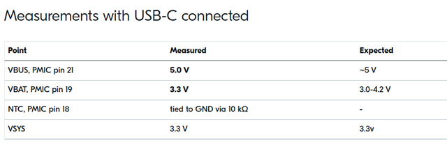

Measurements with USB-C connected
Point Measured Expected
VBUS, PMIC pin 21 5.0 V ~5 V
VBAT, PMIC pin 19 3.3 V 3.0-4.2 V
NTC, PMIC pin 18 tied to GND via 10 kΩ -
VSYS 3.3 V 3.3v
So the input is present, the cell is present, and a thermistor substitute is fitted. The PMIC still reports no battery detected.

    From the table
    VBUS is 5V and VSYS is 3.3V. This is not correct as when VBUS is connected, VSYS should also be 5V. You need to check the soldering issues; for example on the VBUS side. If you have any nPM1300 you can check the operation.
