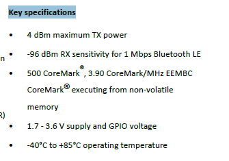

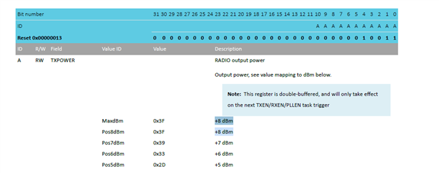

 What is the maximum transmission power of NRF54LS05B? The datasheet says +4, but the register address can be configured with +8dBm. Can you help me confirm it?
 Our dtm test is set to +8dbm, and the conduction test is indeed +8dbm</description><dc:language>en-US</dc:language><generator>Telligent Community 13</generator><lastBuildDate>Fri, 23 Oct 2026 11:18:57 GMT</lastBuildDate><atom:link rel="self" type="application/rss+xml" href="https://devzone.nordicsemi.com/f/nordic-q-a/129481/tx-power-of-nrf54ls05b" /><item><title>RE: TX power of nRF54LS05B</title><link>https://devzone.nordicsemi.com/thread/572549?ContentTypeID=1</link><pubDate>Fri, 23 Oct 2026 11:18:57 GMT</pubDate><guid isPermaLink="false">137ad170-7792-4731-bb38-c0d22fbe4515:52225586-9152-4e23-834e-bab6748f7697</guid><dc:creator>Samruddhi Jadhav</dc:creator><description>&lt;p&gt;Hello,&lt;/p&gt;
&lt;p&gt;It seems that it works to run 8 dBm. However, just to confirm&amp;nbsp;since it is specified that the LSO5 only has 4 dBm, that would be the maximum transmission power and as far as I know, you cannot use more than that.&amp;nbsp;&lt;/p&gt;
