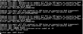

 I am developing based on ble_app_uart at nrf52832 (softdevice s132)
 I modified the program slightly.
 - After the connection is confirmed
 - Send 100 bytes of data to Phone every 150ms
 - Suspend transmission if connection is lost</description><dc:language>en-US</dc:language><generator>Telligent Community 13</generator><lastBuildDate>Thu, 19 Apr 2018 05:44:18 GMT</lastBuildDate><atom:link rel="self" type="application/rss+xml" href="https://devzone.nordicsemi.com/f/nordic-q-a/32024/error-code-13313-0x3401-returned-by-ble_nus_string_send" /><item><title>RE: error code 13313 (0x3401) returned by ble_nus_string_send ?</title><link>https://devzone.nordicsemi.com/thread/128885?ContentTypeID=1</link><pubDate>Thu, 19 Apr 2018 05:44:18 GMT</pubDate><guid isPermaLink="false">137ad170-7792-4731-bb38-c0d22fbe4515:5aab788b-afa4-4af8-8c84-c20892e294f4</guid><dc:creator>Homer Lu</dc:creator><description>&lt;div&gt;I am using SDK v14.2, NRF52832&lt;/div&gt;

&lt;pre class="tw-data-text tw-ta tw-text-small" dir="ltr"&gt;&lt;span lang="en"&gt;Thanks for your advice&lt;br /&gt;&lt;/span&gt;&lt;/pre&gt;
&lt;pre class="tw-data-text tw-ta tw-text-small" id="tw-target-text" dir="ltr"&gt;&lt;span lang="en"&gt;When I checked it, I found the case statement in the function void ble_evt_handler (ble_evt_t const * p_ble_evt, void * p_context).
&lt;br /&gt;I took the test with the procedure below.&lt;/span&gt;&lt;/pre&gt;
&lt;pre class="tw-data-text tw-ta tw-text-small" id="tw-target-text" dir="ltr"&gt;&lt;span lang="en"&gt;&lt;br /&gt;1. Power on the PCA10040. &lt;br /&gt;2. Run nRFToolbox -&amp;gt; UART on my cell phone. &lt;br /&gt;3. Press the &amp;#39;connect&amp;#39; button on my cell phone &lt;br /&gt;4. &amp;quot;&amp;lt;error&amp;gt; ble_gatt: sd_ble_gap_data_length_update () (request) on connection 0x0 returned unexpected value 0x13.&amp;quot; Is output to the terminal. &lt;br /&gt;5. After the BLE connection, data is received on my cell phone. &lt;br /&gt;6. Click Disconnect. &lt;br /&gt;7. My phone does not receive data &lt;br /&gt;8. Press the Connect button again. &lt;br /&gt;9. &amp;quot;&amp;lt;error&amp;gt; ble_gatt: sd_ble_gap_data_length_update () (request) on connection 0x0 returned unexpected value 0x13. &amp;lt;info&amp;gt; app: Connected &amp;lt;error&amp;gt; app: Fatal error &amp;lt;error&amp;gt; app: ERROR 13313 [Unknown error code] at: 0 &amp;quot; is output to the terminal. &lt;br /&gt;&lt;strong&gt;&lt;span style="text-decoration:underline;"&gt;10. While operating the above procedure, I set the breakpoint at BLE_GATTS_EVT_SYS_ATTR_MISSING and run the program. The program at breakpoint did not stop&lt;/span&gt;&lt;/strong&gt;&lt;/span&gt;&lt;/pre&gt;
&lt;p&gt;&lt;img alt=" " src="https://devzone.nordicsemi.com/resized-image/__size/320x240/__key/communityserver-discussions-components-files/4/7573.ble_5F00_nus_5F00_string_5F00_send2.png" /&gt;&lt;/p&gt;

&lt;p&gt;The reason for the error code is that the system attributes haven&amp;#39;t been set. In our SDK, &amp;quot;gatts_cache_manager&amp;quot; --&amp;gt;&amp;nbsp;gscm_local_db_cache_apply() handles this upon the event&amp;nbsp;BLE_ERROR_GATTS_SYS_ATTR_MISSING.&lt;/p&gt;
&lt;p&gt;If you don&amp;#39;t use gatt_cache_manager and gatts_chache_manager, your will have to make your application handle this. If your application doesn&amp;#39;t use bonding, you can do like this:&amp;nbsp;&lt;/p&gt;
&lt;p&gt;&lt;pre class="ui-code" data-mode="c_cpp"&gt;case BLE_GATTS_EVT_SYS_ATTR_MISSING:
    err_code = sd_ble_gatts_sys_attr_set(m_conn_handle, NULL, 0);
&lt;/pre&gt;&lt;/p&gt;&lt;div style="clear:both;"&gt;&lt;/div&gt;</description></item><item><title>RE: error code 13313 (0x3401) returned by ble_nus_string_send ?</title><link>https://devzone.nordicsemi.com/thread/124703?ContentTypeID=1</link><pubDate>Fri, 16 Mar 2018 08:36:22 GMT</pubDate><guid isPermaLink="false">137ad170-7792-4731-bb38-c0d22fbe4515:a9f4ca1d-58f1-4e34-8f51-276c03c307c9</guid><dc:creator>alex kim</dc:creator><description>&lt;p&gt;Thanks for your answer&lt;/p&gt;

I have attached a debug message.
I modified the code as advised, but the same thing.
Please advise.&lt;br /&gt;&lt;img alt=" " src="https://devzone.nordicsemi.com/resized-image/__size/320x240/__key/communityserver-discussions-components-files/4/ble_5F00_nus_5F00_string_5F00_send2.png" /&gt;&lt;/span&gt;&lt;/pre&gt;&lt;div style="clear:both;"&gt;&lt;/div&gt;</description></item><item><title>RE: error code 13313 (0x3401) returned by ble_nus_string_send ?</title><link>https://devzone.nordicsemi.com/thread/124149?ContentTypeID=1</link><pubDate>Tue, 13 Mar 2018 11:34:45 GMT</pubDate><guid isPermaLink="false">137ad170-7792-4731-bb38-c0d22fbe4515:0483e1f2-3a3c-4ffb-9198-9cc101ac3686</guid><dc:creator>FormerMember</dc:creator><description>&lt;p&gt;Could you double check the value of &amp;quot;length&amp;quot; that is being passed to ble_nus_string_send?&lt;/p&gt;
