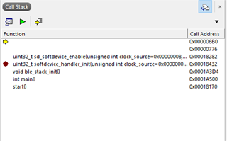

<?xml-stylesheet type="text/xsl" href="https://devzone.nordicsemi.com/cfs-file/__key/system/syndication/rss.xsl" media="screen"?><rss version="2.0" xmlns:dc="http://purl.org/dc/elements/1.1/" xmlns:slash="http://purl.org/rss/1.0/modules/slash/" xmlns:wfw="http://wellformedweb.org/CommentAPI/" xmlns:atom="http://www.w3.org/2005/Atom"><channel><title>nrf51822, SDK 9 and Segger Embedded Sutdio</title><link>https://devzone.nordicsemi.com/f/nordic-q-a/36592/nrf51822-sdk-9-and-segger-embedded-sutdio</link><description>We are using a nrf51822AC Chip with SDK 9 and Softdevice S110. We want to use Segger Embedded Studio 3.40.
 I have imported the BLE HRS Sample from the SDK an did the settings as described in https://devzone.nordicsemi.com/b/blog/posts/segger-embedded</description><dc:language>en-US</dc:language><generator>Telligent Community 13</generator><lastBuildDate>Thu, 19 Jul 2018 08:10:02 GMT</lastBuildDate><atom:link rel="self" type="application/rss+xml" href="https://devzone.nordicsemi.com/f/nordic-q-a/36592/nrf51822-sdk-9-and-segger-embedded-sutdio" /><item><title>RE: nrf51822, SDK 9 and Segger Embedded Sutdio</title><link>https://devzone.nordicsemi.com/thread/140612?ContentTypeID=1</link><pubDate>Thu, 19 Jul 2018 08:10:02 GMT</pubDate><guid isPermaLink="false">137ad170-7792-4731-bb38-c0d22fbe4515:79b5dbae-4829-43e8-8237-3c04cef4a6ee</guid><dc:creator>Matthias Sacher</dc:creator><description>&lt;p&gt;Found a solution here:&lt;/p&gt;
&lt;p&gt;&lt;a href="https://devzone.nordicsemi.com/f/nordic-q-a/35227/nrf51802-goes-to-hardfault-on-sd_softdevice_enable-call"&gt;https://devzone.nordicsemi.com/f/nordic-q-a/35227/nrf51802-goes-to-hardfault-on-sd_softdevice_enable-call&lt;/a&gt;&lt;/p&gt;
&lt;p&gt;This works for me.&lt;/p&gt;
&lt;p&gt;Debugger -&amp;gt; Entry Point Symbol: Chnage from &lt;em&gt;None&lt;/em&gt; to No&lt;/p&gt;&lt;div style="clear:both;"&gt;&lt;/div&gt;</description></item></channel></rss>
