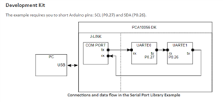

In our application we need to receive data from two uart together
Dear Sir,
we are developing an application on the nRF52840 kit with SDK 15.0.0. We are using Keil as compiler. In our application we need to receive data from two uart together. If we use only one uart the application work fine, but if we add the second uart the firmware have a strange behavior: one of the two uart after a certain time stops to work. The time and the uart that stops are not always the same, it seems casual.
What can happen?
Attached you can find the files main.c, the nrf_serial library and the file sdk_config.h.
Please, help us because we are very worry, we need to complete the project soon.

            (void)nrf_serial_flush(&serial1_uarte, 0);
  • Hi Gianmarco,
    So if I understand correctly you have issues with the unmodified "Serial Port Library Example with two UARTEs" and your modified version?
    (Remember how the unmodified example is supposed to work:)
    How are you connected to the kit (physically)?
    do you get any error codes or information when you debug the application?
  • Hi Martin,
    I have modified the files in attached ( nrf_serial.h, nrf_serial.c and sdk_config.h ), to receive data from two uart together as in this llink.
    I have connected the kit so:
    When the a serial not work, i receive the error code 0x0D.
    What do you think ?
