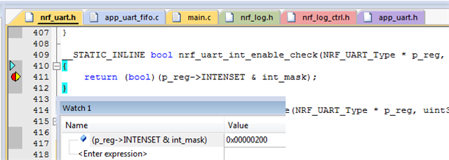

&lt;p&gt;Thanks !&lt;/p&gt;&lt;div style="clear:both;"&gt;&lt;/div&gt;</description></item><item><title>RE: nrf51 s130 sdk12.3 , uart, how to Allowing LOG (NRF_LOG_INIT) for TX in parallel with app_fifo_init (APP_UART_FIFO_INIT) for RTX</title><link>https://devzone.nordicsemi.com/thread/161173?ContentTypeID=1</link><pubDate>Tue, 11 Dec 2018 11:38:21 GMT</pubDate><guid isPermaLink="false">137ad170-7792-4731-bb38-c0d22fbe4515:bec83d3e-61b0-4ed3-bfb5-d53ac56d0678</guid><dc:creator>Susheel Nuguru</dc:creator><description>&lt;p&gt;&lt;img height="96" src="https://devzone.nordicsemi.com/resized-image/__size/320x240/__key/support-attachments/beef5d1b77644c448dabff31668f3a47-299db751a2324c67943a7bf597d75fbd/pastedimage1544528203549v1.png" width="627" alt=" " /&gt;&lt;/p&gt;
&lt;p&gt;The documentation tells you that this occurs when there is error detected on the RXD line.&lt;/p&gt;

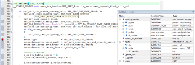

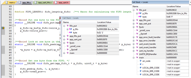

&lt;p&gt;Are you sure that on your custom board the pin numbers you selected are properly connected to the peer UART pins and are NOT used by anything else? (i.e, and their state is not controlled by any other external circuitry?)&lt;/p&gt;&lt;div style="clear:both;"&gt;&lt;/div&gt;</description></item><item><title>RE: nrf51 s130 sdk12.3 , uart, how to Allowing LOG (NRF_LOG_INIT) for TX in parallel with app_fifo_init (APP_UART_FIFO_INIT) for RTX</title><link>https://devzone.nordicsemi.com/thread/160830?ContentTypeID=1</link><pubDate>Sat, 08 Dec 2018 11:15:33 GMT</pubDate><guid isPermaLink="false">137ad170-7792-4731-bb38-c0d22fbe4515:1ea3d701-fca7-44ed-922a-2d3757f63c17</guid><dc:creator>Ron</dc:creator><description>&lt;p&gt;I&amp;#39;ve added a stack view of the error&lt;/p&gt;
&lt;p&gt;the right call stack is after the error occurred , on the 5 charachter , the left call stack is at the first charachter sent by the printf (no error at that point)&lt;/p&gt;
&lt;p&gt;after the 4th the printf invokes a UART0_IRQHandler with - a uart error interrupt&lt;/p&gt;
&lt;p&gt;That does not occur on the NRF51 DK only on my own custome hardware&lt;/p&gt;
&lt;p&gt;I would really appreciate any help from you guys&lt;/p&gt;
&lt;p&gt;thanks&lt;/p&gt;
&lt;p&gt;Eran&lt;/p&gt;
&lt;p&gt;&lt;img src="https://devzone.nordicsemi.com/resized-image/__size/640x480/__key/communityserver-discussions-components-files/4/pastedimage1544267604843v1.png" alt=" " /&gt;&lt;/p&gt;&lt;div style="clear:both;"&gt;&lt;/div&gt;</description></item><item><title>RE: nrf51 s130 sdk12.3 , uart, how to Allowing LOG (NRF_LOG_INIT) for TX in parallel with app_fifo_init (APP_UART_FIFO_INIT) for RTX</title><link>https://devzone.nordicsemi.com/thread/160800?ContentTypeID=1</link><pubDate>Fri, 07 Dec 2018 18:30:46 GMT</pubDate><guid isPermaLink="false">137ad170-7792-4731-bb38-c0d22fbe4515:ff5685b5-435f-4398-971b-5d7c3f1fe9ea</guid><dc:creator>Ron</dc:creator><description>&lt;p&gt;&lt;em&gt;basically I receive a :&lt;/em&gt;&lt;/p&gt;
&lt;p&gt;&lt;em&gt;NRF_UART_INT_MASK_ERROR&lt;/em&gt;&lt;span&gt;&amp;nbsp;&amp;nbsp;&lt;/span&gt;&lt;/p&gt;
&lt;p&gt;Error detection interrupt.&lt;/p&gt;
&lt;p&gt;when trying to use printf..&lt;/p&gt;&lt;div style="clear:both;"&gt;&lt;/div&gt;</description></item><item><title>RE: nrf51 s130 sdk12.3 , uart, how to Allowing LOG (NRF_LOG_INIT) for TX in parallel with app_fifo_init (APP_UART_FIFO_INIT) for RTX</title><link>https://devzone.nordicsemi.com/thread/160754?ContentTypeID=1</link><pubDate>Fri, 07 Dec 2018 13:37:59 GMT</pubDate><guid isPermaLink="false">137ad170-7792-4731-bb38-c0d22fbe4515:52ede544-62f3-456b-980e-1a43d16b0550</guid><dc:creator>Ron</dc:creator><description>&lt;p&gt;Hi - Update&lt;/p&gt;
