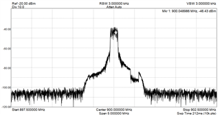

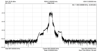

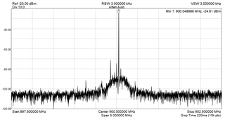

&lt;p&gt;Thank you for your assistance, we are using the 4.7uF as you suggested.&lt;/p&gt;&lt;div style="clear:both;"&gt;&lt;/div&gt;</description></item><item><title>RE: Prototype with nRF9160 does not register on network, returns +CEREG: 0</title><link>https://devzone.nordicsemi.com/thread/300275?ContentTypeID=1</link><pubDate>Wed, 17 Mar 2021 06:25:57 GMT</pubDate><guid isPermaLink="false">137ad170-7792-4731-bb38-c0d22fbe4515:9e088338-af9b-45b1-9f50-07ac7acfae97</guid><dc:creator>EmbeddedDan</dc:creator><description>&lt;p&gt;Hi Ketil&lt;/p&gt;
&lt;p&gt;I did not have any success with a 4.7uF capacitor.&amp;nbsp; Do you belief the issue we are experiencing to be an RF problem? &lt;/p&gt;
&lt;p&gt;Signal strength on the nRF9160_DK is: +CESQ: 99,99,255,255,23,57 and on the prototype its: +CESQ: 99,99,255,255,255,255&lt;/p&gt;
&lt;p&gt;The local network using band 8 (900Mhz), this is the output with constant carrier at 900MHz (AT%XRFTEST=1,1,8,9000,17,0,4,12,0,0,0,0)&lt;/p&gt;
&lt;p&gt;&lt;img src="https://devzone.nordicsemi.com/resized-image/__size/320x240/__key/communityserver-discussions-components-files/4/CW.png" alt=" " /&gt;&lt;/p&gt;
&lt;p&gt;Output with QPSK modulation (AT%XRFTEST=1,1,8,9000,17,0,0,12,0,0,0,0)&lt;/p&gt;
&lt;p&gt;&lt;img src="https://devzone.nordicsemi.com/resized-image/__size/320x240/__key/communityserver-discussions-components-files/4/QPSK.png" alt=" " /&gt;&lt;/p&gt;
&lt;p&gt;Output with BPSK modulation (AT%XRFTEST=1,1,8,9000,17,0,3,12,0,0,0,0)&lt;/p&gt;
&lt;p&gt;&lt;img src="https://devzone.nordicsemi.com/resized-image/__size/320x240/__key/communityserver-discussions-components-files/4/BPSK.png" alt=" " /&gt;&lt;/p&gt;&lt;div style="clear:both;"&gt;&lt;/div&gt;</description></item><item><title>RE: Prototype with nRF9160 does not register on network, returns +CEREG: 0</title><link>https://devzone.nordicsemi.com/thread/300146?ContentTypeID=1</link><pubDate>Tue, 16 Mar 2021 13:17:15 GMT</pubDate><guid isPermaLink="false">137ad170-7792-4731-bb38-c0d22fbe4515:91fd0c64-3cce-48c6-b7b5-13540bf5f21d</guid><dc:creator>EmbeddedDan</dc:creator><description>&lt;p&gt;Thank you for looking at this Ketil.&lt;/p&gt;
