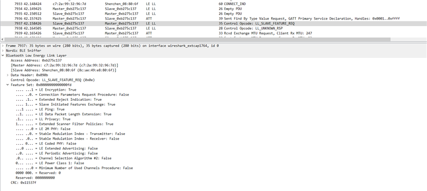

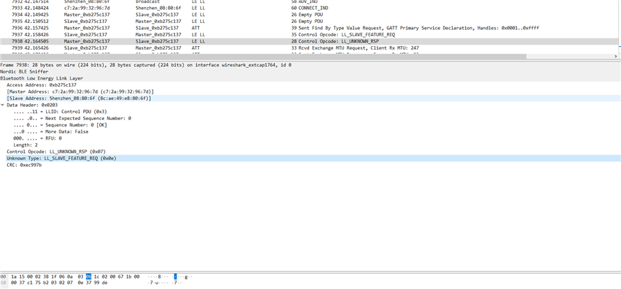

<?xml-stylesheet type="text/xsl" href="https://devzone.nordicsemi.com/cfs-file/__key/system/syndication/rss.xsl" media="screen"?><rss version="2.0" xmlns:dc="http://purl.org/dc/elements/1.1/" xmlns:slash="http://purl.org/rss/1.0/modules/slash/" xmlns:wfw="http://wellformedweb.org/CommentAPI/" xmlns:atom="http://www.w3.org/2005/Atom"><channel><title>When nrf52840 Dongle receives LL_SLAVE_FEATURE_REQ, it returns LL_UNKNOWN_RSP. What is the reason?</title><link>https://devzone.nordicsemi.com/f/nordic-q-a/75380/when-nrf52840-dongle-receives-ll_slave_feature_req-it-returns-ll_unknown_rsp-what-is-the-reason</link><description>I am using nrf52840&amp;#39;s dongle development software, and I found that when the slave device sends LL_SLAVE_FEATURE_REQ , the host will return LL_UNKNOWN_RSP. I want to know why this is?
 Dongle is a central device, using nrf-ble-driver-4.1.4 firmware and</description><dc:language>en-US</dc:language><generator>Telligent Community 13</generator><lastBuildDate>Wed, 27 Oct 2021 10:46:09 GMT</lastBuildDate><atom:link rel="self" type="application/rss+xml" href="https://devzone.nordicsemi.com/f/nordic-q-a/75380/when-nrf52840-dongle-receives-ll_slave_feature_req-it-returns-ll_unknown_rsp-what-is-the-reason" /><item><title>RE: When nrf52840 Dongle receives LL_SLAVE_FEATURE_REQ, it returns LL_UNKNOWN_RSP. What is the reason?</title><link>https://devzone.nordicsemi.com/thread/336162?ContentTypeID=1</link><pubDate>Wed, 27 Oct 2021 10:46:09 GMT</pubDate><guid isPermaLink="false">137ad170-7792-4731-bb38-c0d22fbe4515:02a56884-a3ed-4638-bf76-8430356f7805</guid><dc:creator>ovrebekk</dc:creator><description>&lt;p&gt;Hi&amp;nbsp;&lt;/p&gt;

&lt;p&gt;As far as I know the softdevice can handle host side initiate feature exchange from the peer (send LL_FEATURE_RSP to LL_FEATURE_REQ) but we don&amp;#39;t proactively send&amp;nbsp;&lt;span&gt;LL_FEATURE_REQ&lt;/span&gt;&lt;/p&gt;&lt;div style="clear:both;"&gt;&lt;/div&gt;</description></item><item><title>RE: When nrf52840 Dongle receives LL_SLAVE_FEATURE_REQ, it returns LL_UNKNOWN_RSP. What is the reason?</title><link>https://devzone.nordicsemi.com/thread/310785?ContentTypeID=1</link><pubDate>Thu, 20 May 2021 13:38:11 GMT</pubDate><guid isPermaLink="false">137ad170-7792-4731-bb38-c0d22fbe4515:01aa8d7b-7fd7-42b1-944a-95ee492a1e26</guid><dc:creator>kxct</dc:creator><description>&lt;p&gt;Hi Hung Bui&lt;/p&gt;
&lt;p&gt;Thank you, how can the host side initiate feature exchange?&lt;/p&gt;&lt;div style="clear:both;"&gt;&lt;/div&gt;</description></item><item><title>RE: When nrf52840 Dongle receives LL_SLAVE_FEATURE_REQ, it returns LL_UNKNOWN_RSP. What is the reason?</title><link>https://devzone.nordicsemi.com/thread/310784?ContentTypeID=1</link><pubDate>Thu, 20 May 2021 13:31:14 GMT</pubDate><guid isPermaLink="false">137ad170-7792-4731-bb38-c0d22fbe4515:c7a57076-0c24-45e1-8960-e53132cefb54</guid><dc:creator>Hung Bui</dc:creator><description>&lt;p&gt;Hi kxct,&amp;nbsp;&lt;/p&gt;
&lt;p&gt;Our softdevice doesn&amp;#39;t support slave-initialized feature exchange that&amp;#39;s why it return&amp;nbsp;&lt;span&gt;LL_UNKNOWN_RSP.&amp;nbsp;&lt;/span&gt;&lt;/p&gt;&lt;div style="clear:both;"&gt;&lt;/div&gt;</description></item></channel></rss>
