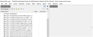

nRF52840 DK can not advertising extension when using zephyr nRF Connect SDK v1.6.1
HW : nRF52840DK
SW :  nRF3.7.0 desktop tool
IDE: SES
Project: periodic_sync or periodic_adv
Operation:
1. build -> rebuild the solution,  success;
2. Target -> Download zephyr/zephyr.elf,  success;
result:
nRF52840DK LED1 blink , no any advertising packet can be received.
Anyone can help me why the extend adv pkt can not received, and how should I do correctly?

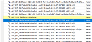

    I use the SES IDE, it seems the log not print out, and I can not make it works.
    The 52840DK board led1 blink priodically, the ellisys not capture any extend adv pkt either.

  • Hi  Amanda ,
    The project SDK you attached is work well on my 52840DK, and ellisys can capture the sync pkt also.
    Besides, on my local PC I am using v1.6.1 SDK;
    This is the SDK I download from nRF Connect v3.7.0 ToolChain Manager;
    I add the  CONFIG_BT_LL_SW_SPLIT=y into prj.conf of periodic_sync, but it still not work.
    periodic_sync_v01.zip
    Can you help check the reason why my sdk not work?

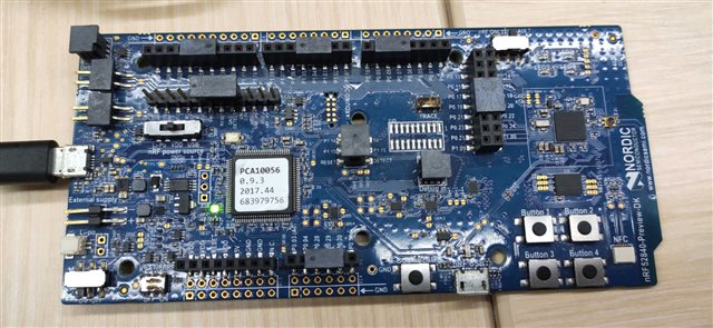

  • Hi Amanda ,
    which board you test the issue, 52840 Preview DK or 52840 DK board?
    I am using the  52840 Preview DK, does it have the problem?
    The PC I am using only have one serial port via DK.
