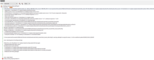

  command failed with return code: 1</title><link>https://devzone.nordicsemi.com/thread/325387?ContentTypeID=1</link><pubDate>Wed, 18 Aug 2021 05:41:57 GMT</pubDate><guid isPermaLink="false">137ad170-7792-4731-bb38-c0d22fbe4515:25be5b3f-e466-4c37-a57a-4397f5c45c46</guid><dc:creator>sotillo2409</dc:creator><description>&lt;p&gt;So sorry i upload the wrong image, my board is hello_board, here the real output:&lt;/p&gt;
&lt;p&gt;&lt;img alt=" " src="https://devzone.nordicsemi.com/resized-image/__size/640x480/__key/communityserver-discussions-components-files/4/C3aptura.PNG" /&gt;&lt;/p&gt;
&lt;p&gt;The output of Segger is correct.&lt;/p&gt;

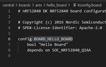

&lt;p&gt;&lt;span&gt;......OK this issue is closed, i missed on BOARD_HELLO_BOARD on Kconfig&lt;/span&gt;&lt;/p&gt;
&lt;p&gt;&lt;span&gt;&lt;img src="https://devzone.nordicsemi.com/resized-image/__size/640x480/__key/communityserver-discussions-components-files/4/pastedimage1629265152072v3.png" alt=" " /&gt;&lt;/span&gt;&lt;/p&gt;

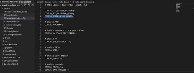

&lt;p&gt;&lt;span&gt;and later adding:&amp;nbsp;&lt;/span&gt;&lt;/p&gt;
&lt;p&gt;&lt;span&gt;&lt;img src="https://devzone.nordicsemi.com/resized-image/__size/640x480/__key/communityserver-discussions-components-files/4/pastedimage1629265185567v4.png" alt=" " /&gt;&lt;/span&gt;&lt;/p&gt;

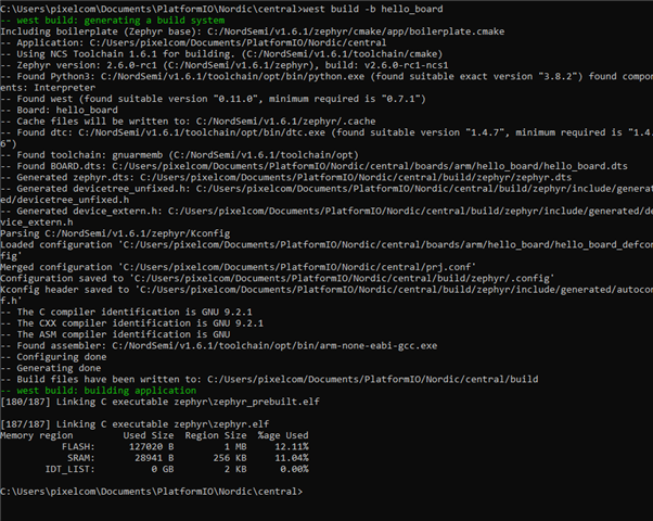

&lt;p&gt;&lt;span&gt;Is working:&lt;/span&gt;&lt;/p&gt;
&lt;p&gt;&lt;span&gt;&amp;nbsp;&lt;img src="https://devzone.nordicsemi.com/resized-image/__size/640x480/__key/communityserver-discussions-components-files/4/pastedimage1629265226547v5.png" alt=" " /&gt;&lt;/span&gt;&lt;/p&gt;

&lt;p&gt;Is the custom board that you created named &amp;#39;custom_board&amp;#39; or &amp;#39;hello_board&amp;#39;? In your first image it looks like you are trying to build using a board called &amp;#39;custom_board&amp;#39; which is not found. Is it correct that your new board is called &amp;#39;custom_board&amp;#39;? If not, what happens if you try &lt;code&gt;west build -b hello_board&lt;/code&gt; ?&lt;/p&gt;
&lt;p&gt;In your second image it looks like a config named &amp;#39;BOARD_HELLO_BOARD&amp;#39; can&amp;#39;t be found. Have you gone through all files in the &amp;#39;hello_board&amp;#39; folder and updated everything? In these files I suppose anything that says &amp;#39;nrf52840dk_nrf52840&amp;#39; should be replaced with &amp;#39;hello_board&amp;#39;.&lt;/p&gt;
