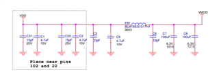

 P109 from nRF52840 is connected to the nRESET of nRF9160. To control the resets, P109 is configured as output high (3.3V) for most of the time</description><dc:language>en-US</dc:language><generator>Telligent Community 13</generator><lastBuildDate>Thu, 09 Sep 2021 06:59:51 GMT</lastBuildDate><atom:link rel="self" type="application/rss+xml" href="https://devzone.nordicsemi.com/f/nordic-q-a/78955/correct-voltage-to-nreset-pin-on-nrf9160" /><item><title>RE: Correct voltage to nRESET pin on nRF9160</title><link>https://devzone.nordicsemi.com/thread/328709?ContentTypeID=1</link><pubDate>Thu, 09 Sep 2021 06:59:51 GMT</pubDate><guid isPermaLink="false">137ad170-7792-4731-bb38-c0d22fbe4515:9cfe1bac-b44f-4198-a2c7-59e1b0c78333</guid><dc:creator>michaelatom</dc:creator><description>&lt;p&gt;Yes, I implemented their suggested configuration.&lt;br /&gt;I removed the 2 100uF from the modem board and this improved the inrush current, also instead of cutting the power to the whole board, I&amp;#39;m powering it from startup and using the Enable pin to control the modem.&lt;br /&gt;Will continue to verify it and if it solves the issue, will close the ticket&lt;/p&gt;&lt;div style="clear:both;"&gt;&lt;/div&gt;</description></item><item><title>RE: Correct voltage to nRESET pin on nRF9160</title><link>https://devzone.nordicsemi.com/thread/328107?ContentTypeID=1</link><pubDate>Mon, 06 Sep 2021 07:48:35 GMT</pubDate><guid isPermaLink="false">137ad170-7792-4731-bb38-c0d22fbe4515:933e1c00-06b0-4648-951e-779d5170a068</guid><dc:creator>H&amp;#229;kon Alseth</dc:creator><description>&lt;p&gt;Hi,&lt;/p&gt;

&lt;p&gt;It is very clear that there&amp;#39;s a problem with your boost converter. It is dropping almost 2V!&lt;/p&gt;
&lt;p&gt;Have you followed the reference design from the vendor wrt. capacitance etc?&lt;/p&gt;

&lt;p&gt;It sounds like your batteries / boost converter isn&amp;#39;t able to handle the peaks of the modem. These can be quite high, in the 500 mA range. Could you scope the VDD and&amp;nbsp;battery voltage to see how it behaves? What boost converter ic are you using?&lt;/p&gt;
&lt;p&gt;If you dip underneath 3.0V, the nRF9160 will do a brown out reset.&lt;/p&gt;

&lt;p&gt;Haven&amp;#39;t been able to follow up on the possible disconnected part.&lt;/p&gt;
&lt;p&gt;I&amp;#39;m having stability issues on my system from turning the modem ON.&lt;/p&gt;
&lt;p&gt;Whenever I power the modem there is a significant voltage drop that causes the whole board to reset.&lt;/p&gt;
&lt;p&gt;The Enable pin is connected to VDD via a 10k resistor and VDD_GPIO is directly connected to VDD&lt;br /&gt;I managed to reduce by half the drop if I power the reset line before&amp;nbsp;providing power to the VDD pins.&lt;/p&gt;
&lt;p&gt;The following pictures show the power section from the nRF9160 module.&lt;br /&gt;&lt;img src="https://devzone.nordicsemi.com/resized-image/__size/320x240/__key/communityserver-discussions-components-files/4/pastedimage1630507045080v1.png" alt=" " /&gt;&lt;/p&gt;
&lt;p&gt;&lt;img src="https://devzone.nordicsemi.com/resized-image/__size/320x240/__key/communityserver-discussions-components-files/4/pastedimage1630507058090v2.png" alt=" " /&gt;&lt;/p&gt;
&lt;p&gt;VMOD is the external power which comes from a 3.3V boost (powered from 2AA Alkaline batteries)&lt;/p&gt;
&lt;p&gt;&lt;/p&gt;
&lt;p&gt;Is there a modification or specific booting sequence that I should follow to mitigate the drops?&lt;/p&gt;
&lt;p&gt;&lt;/p&gt;&lt;div style="clear:both;"&gt;&lt;/div&gt;</description></item><item><title>RE: Correct voltage to nRESET pin on nRF9160</title><link>https://devzone.nordicsemi.com/thread/326929?ContentTypeID=1</link><pubDate>Fri, 27 Aug 2021 08:57:14 GMT</pubDate><guid isPermaLink="false">137ad170-7792-4731-bb38-c0d22fbe4515:45dd0727-3386-4e48-9b26-3612f4342470</guid><dc:creator>H&amp;#229;kon Alseth</dc:creator><description>&lt;p&gt;Hi,&lt;/p&gt;
