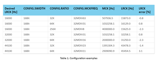

&lt;p&gt;Max&amp;nbsp;MCK frequency is&amp;nbsp;4000&lt;span&gt; &lt;/span&gt;kHz. See this link:&amp;nbsp;&lt;a href="https://infocenter.nordicsemi.com/index.jsp?topic=%2Fps_nrf9160%2Fi2s.html&amp;amp;cp=2_0_0_5_6_10_0&amp;amp;anchor=unique_325236725"&gt;https://infocenter.nordicsemi.com/index.jsp?topic=%2Fps_nrf9160%2Fi2s.html&amp;amp;cp=2_0_0_5_6_10_0&amp;amp;anchor=unique_325236725&lt;/a&gt;&lt;/p&gt;
&lt;p&gt;Also take a look at&amp;nbsp;&lt;span&gt;Table 1.&lt;span&gt;&amp;nbsp;&lt;/span&gt;&lt;/span&gt;&lt;span&gt;Configuration examples,&amp;nbsp;&lt;a href="https://infocenter.nordicsemi.com/index.jsp?topic=%2Fps_nrf9160%2Fi2s.html&amp;amp;cp=2_0_0_5_6_4&amp;amp;anchor=concept_ezd_bqy_vr"&gt;https://infocenter.nordicsemi.com/index.jsp?topic=%2Fps_nrf9160%2Fi2s.html&amp;amp;cp=2_0_0_5_6_4&amp;amp;anchor=concept_ezd_bqy_vr&lt;/a&gt;&lt;/span&gt;&lt;/p&gt;
&lt;p&gt;&lt;span&gt;&lt;img src="https://devzone.nordicsemi.com/resized-image/__size/320x240/__key/communityserver-discussions-components-files/4/pastedimage1641560034667v1.png" alt=" " /&gt;&lt;/span&gt;&lt;/p&gt;&lt;div style="clear:both;"&gt;&lt;/div&gt;</description></item></channel></rss>
