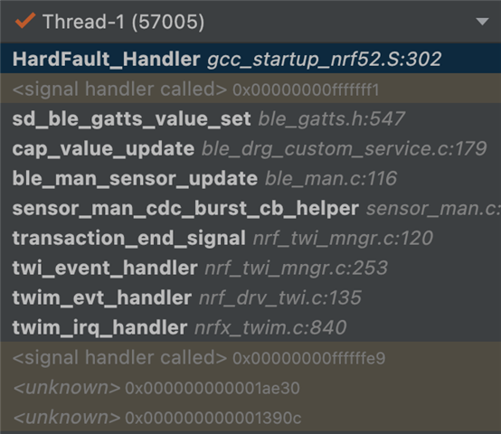

&lt;p&gt;I found the problem. I was calling this from a TWI manager callback with the interrupt priority configured HIGH. I switched it to LOW and it seems to work now, though oddly enough some blocking transactions had to be switched to LOW_MID to work.&lt;/p&gt;
&lt;p&gt;I eventually stumbled across &lt;a href="https://devzone.nordicsemi.com/f/nordic-q-a/18077/things-allow-not-allowed-to-call-from-callbacks-nrf52-s132"&gt;this issue&lt;/a&gt;, which gave me the clue.&lt;/p&gt;

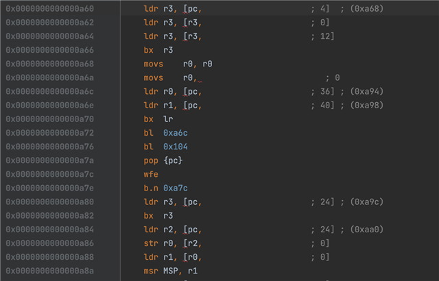

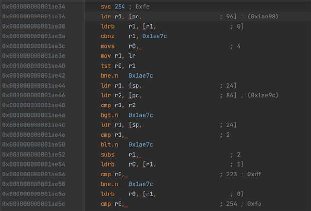

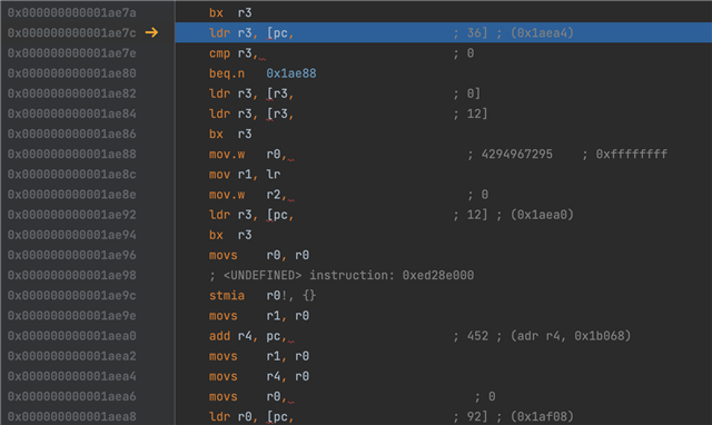

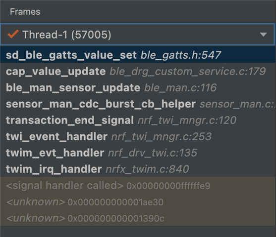

&lt;p&gt;Here&amp;#39;s the call stack:&lt;/p&gt;
&lt;p&gt;&lt;img alt=" " src="https://devzone.nordicsemi.com/resized-image/__size/640x480/__key/communityserver-discussions-components-files/4/Screen-Shot-2022_2D00_01_2D00_26-at-10.57.15-AM.png" /&gt;&lt;/p&gt;
&lt;p&gt;Here are the different chunks of disassembly (a new pic each time it jumps)&lt;/p&gt;
&lt;p&gt;&lt;img alt=" " src="https://devzone.nordicsemi.com/resized-image/__size/640x480/__key/communityserver-discussions-components-files/4/Screen-Shot-2022_2D00_01_2D00_26-at-10.57.36-AM.png" /&gt;&lt;/p&gt;
&lt;p&gt;&lt;img alt=" " src="https://devzone.nordicsemi.com/resized-image/__size/640x480/__key/communityserver-discussions-components-files/4/Screen-Shot-2022_2D00_01_2D00_26-at-10.57.53-AM.png" /&gt;&lt;img alt=" " src="https://devzone.nordicsemi.com/resized-image/__size/640x480/__key/communityserver-discussions-components-files/4/Screen-Shot-2022_2D00_01_2D00_26-at-10.58.18-AM.png" /&gt;&lt;/p&gt;
&lt;p&gt;It looks like it goes to the fault once I step through that &amp;quot;bx r3&amp;quot; instruction at address 0x1ae86.&lt;/p&gt;
&lt;p&gt;And here&amp;#39;s after it hits the fault:&lt;/p&gt;
&lt;p&gt;&lt;img alt=" " src="https://devzone.nordicsemi.com/resized-image/__size/640x480/__key/communityserver-discussions-components-files/4/Screen-Shot-2022_2D00_01_2D00_26-at-11.00.55-AM.png" /&gt;&lt;/p&gt;&lt;div style="clear:both;"&gt;&lt;/div&gt;</description></item><item><title>RE: Call to sd_ble_gatts_value_set() does not return - S113</title><link>https://devzone.nordicsemi.com/thread/349796?ContentTypeID=1</link><pubDate>Wed, 26 Jan 2022 14:28:41 GMT</pubDate><guid isPermaLink="false">137ad170-7792-4731-bb38-c0d22fbe4515:bd4839c4-a042-4d1e-b65d-569c9fe26ee3</guid><dc:creator>Sigurd</dc:creator><description>&lt;p&gt;How does the callstack look like? and the disassembly? What is the value of the PC(program counter)? Does the PC change when this occurs?&lt;/p&gt;&lt;div style="clear:both;"&gt;&lt;/div&gt;</description></item><item><title>RE: Call to sd_ble_gatts_value_set() does not return - S113</title><link>https://devzone.nordicsemi.com/thread/349767?ContentTypeID=1</link><pubDate>Wed, 26 Jan 2022 13:16:30 GMT</pubDate><guid isPermaLink="false">137ad170-7792-4731-bb38-c0d22fbe4515:0462c403-2297-4c6c-ba66-8ea11a50a22d</guid><dc:creator>underpickled</dc:creator><description>&lt;p&gt;Hi Sigurd, I&amp;#39;ve already got that in there. That&amp;#39;s how I know it doesn&amp;#39;t return. Sorry, I probably should have specified that more explicitly.&lt;/p&gt;&lt;div style="clear:both;"&gt;&lt;/div&gt;</description></item><item><title>RE: Call to sd_ble_gatts_value_set() does not return - S113</title><link>https://devzone.nordicsemi.com/thread/349733?ContentTypeID=1</link><pubDate>Wed, 26 Jan 2022 11:53:14 GMT</pubDate><guid isPermaLink="false">137ad170-7792-4731-bb38-c0d22fbe4515:1af33e70-baab-4f60-ad58-efcde058ebda</guid><dc:creator>Sigurd</dc:creator><description>&lt;p&gt;Hi,&lt;/p&gt;
