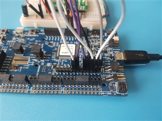

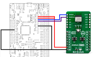

&lt;p&gt;The example is hello_world. The board is a BLE8 Click by Mikroe electronics. It has a ANNA-B112 and we use it as a dev board for the the ANNA-B12.&lt;/p&gt;
&lt;p&gt;This is my wiring and connection to the nRF52840-DK. In the SDK, I have tried a custom board that we use on our production ANNA-B112 boards, the ubx_evkannab1_nrf52832.&lt;/p&gt;
&lt;p&gt;&lt;img alt=" " src="https://devzone.nordicsemi.com/resized-image/__size/320x240/__key/communityserver-discussions-components-files/4/20220211_5F00_110923.jpg" /&gt;&lt;img alt=" " src="https://devzone.nordicsemi.com/resized-image/__size/320x240/__key/communityserver-discussions-components-files/4/20220211_5F00_110900.jpg" /&gt;&lt;/p&gt;&lt;div style="clear:both;"&gt;&lt;/div&gt;</description></item><item><title>RE: Cannot debug ANNA B112 with nrf52840-DK as Jlink</title><link>https://devzone.nordicsemi.com/thread/352556?ContentTypeID=1</link><pubDate>Fri, 11 Feb 2022 10:56:26 GMT</pubDate><guid isPermaLink="false">137ad170-7792-4731-bb38-c0d22fbe4515:2022038d-e74f-4c08-bf37-acacbeef9320</guid><dc:creator>JONATHAN LL</dc:creator><description>&lt;p&gt;Stil not able to replicate the issue, but could see if the issue stil &lt;span style="font-size:12px;"&gt;presist&lt;/span&gt;&amp;nbsp;if MCUBoot is not included. It might be a trigering factor for the issue you are seeing.&amp;nbsp;&lt;br /&gt;&lt;br /&gt;Can you test with a different NCS tag like 1.7.0 to see if the issue still occurs. Can you give me an example that &lt;span style="font-size:12px;"&gt;consistently&lt;/span&gt;&amp;nbsp;fails to debug.&amp;nbsp;&lt;br /&gt;&lt;br /&gt;Regards,&lt;br /&gt;Jonathan&lt;/p&gt;&lt;div style="clear:both;"&gt;&lt;/div&gt;</description></item><item><title>RE: Cannot debug ANNA B112 with nrf52840-DK as Jlink</title><link>https://devzone.nordicsemi.com/thread/352086?ContentTypeID=1</link><pubDate>Wed, 09 Feb 2022 13:31:39 GMT</pubDate><guid isPermaLink="false">137ad170-7792-4731-bb38-c0d22fbe4515:dcd3d160-f8f4-40c5-ac04-ba475bcbc33d</guid><dc:creator>emlynkz</dc:creator><description>&lt;p&gt;It still never reaches my breakpoint in main.&amp;nbsp;&lt;/p&gt;
