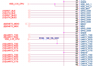

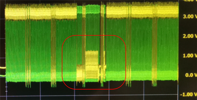

[quote user="ndc_bee"]The nRF52832 on the device has several GPIOs connected to the core board. Could it be that the GPIOs of the core board output high current or high voltage and damage the nRF52832 chip? Because from the waveform of the SWD data line captured by the oscilloscope, the SWDIO signal on the bad device seems to be abnormal.[/quote]

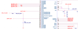

&lt;p&gt;Potentially, if there are two outputs (ie. nRF low, core board high), you can potentially damage the device over time. However, this should show up if you check the current of the bad board vs. a good board. I also see that the nRESET pin is routed, is this controlled by the external core board? If so, you could try to check if this pin is ever pulled low externally.&lt;/p&gt;

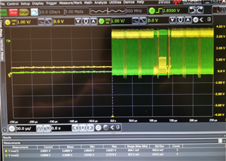

&lt;p&gt;When you mention the waveform, I assume it is this section in red that you are worried about:&lt;/p&gt;
&lt;p&gt;&lt;img src="https://devzone.nordicsemi.com/resized-image/__size/640x480/__key/communityserver-discussions-components-files/4/pastedimage1644587741196v1.png" alt=" " /&gt;&lt;/p&gt;

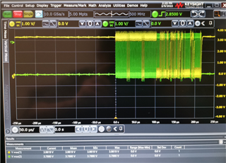

&lt;p&gt;It is hard to say if this is noise, or if the nRF keeps the line low. Do you have a log from the programming/recovery sequence?&lt;/p&gt;

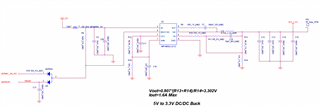

&lt;p&gt;&lt;img src="https://devzone.nordicsemi.com/resized-image/__size/320x240/__key/communityserver-discussions-components-files/4/pastedimage1644542787834v1.png" alt=" " /&gt;&lt;/p&gt;
[quote userid="2115" url="~/f/nordic-q-a/84607/nrf52832-cannot-programmed/352405#352405"]Q2: How many devices are failing in total? And how many are produced in total?[/quote]
&lt;p&gt;sample total: 50 PCS&lt;/p&gt;
&lt;p&gt;bad sample: 13 PCS&lt;/p&gt;

&lt;p&gt;The nRF52832 on the device has several GPIOs connected to the core board. Could it be that the GPIOs of the core board output high current or high voltage and damage the nRF52832 chip? Because from the waveform of the SWD data line captured by the oscilloscope, the SWDIO signal on the bad device seems to be abnormal.&lt;/p&gt;
