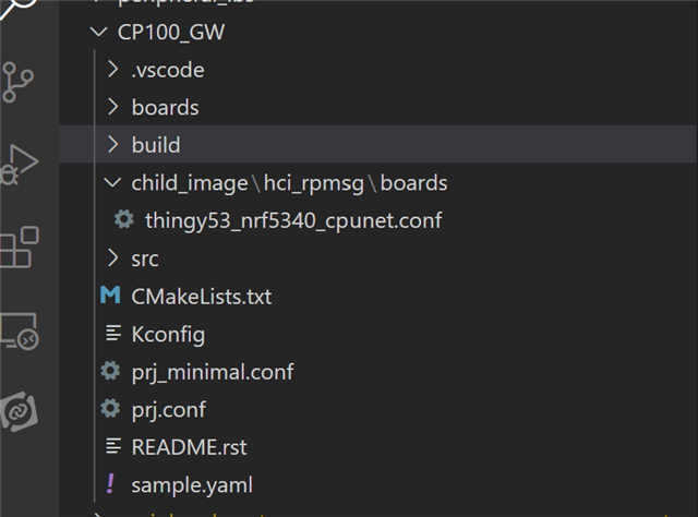

&lt;p&gt;Sorry about the late reply, I have been OoO the last couple of days. The&amp;nbsp;&lt;span&gt;thingy53_nrf5340_cpunet.conf file will only be included if you build for the Thingy53. Seems strange that this file would be generated when building for the DK.&lt;/span&gt;&lt;/p&gt;
&lt;p&gt;&lt;span&gt;How to include and build with specific (child) images is &lt;a href="https://developer.nordicsemi.com/nRF_Connect_SDK/doc/latest/nrf/ug_multi_image.html#ug-multi-image-variables"&gt;explained here, in the multi image user guide section&lt;/a&gt; of our documentation.&lt;/span&gt;&lt;/p&gt;

&lt;p&gt;It appears that the thingy53_nrf5340_cpunet.conf file is not actually included in the build process, but it is the only additional .conf file i have in the project.&lt;/p&gt;
&lt;p&gt;Does that mean that i need to create a new one to change any options within the network build? if so, what would the steps/naming convention be? i cannot seem to find any supporting documentation.&lt;/p&gt;&lt;div style="clear:both;"&gt;&lt;/div&gt;</description></item><item><title>RE: Extended adverts bt_le_ext_adv_create error</title><link>https://devzone.nordicsemi.com/thread/355883?ContentTypeID=1</link><pubDate>Wed, 02 Mar 2022 15:48:39 GMT</pubDate><guid isPermaLink="false">137ad170-7792-4731-bb38-c0d22fbe4515:80544be6-7cd6-4051-9d05-ca9418ea3c38</guid><dc:creator>billywalton</dc:creator><description>&lt;p&gt;Hi&lt;/p&gt;

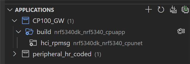

&lt;p&gt;I am really out of ideas now as to what i need to do to enable this feature.&lt;/p&gt;&lt;div style="clear:both;"&gt;&lt;/div&gt;</description></item><item><title>RE: Extended adverts bt_le_ext_adv_create error</title><link>https://devzone.nordicsemi.com/thread/355599?ContentTypeID=1</link><pubDate>Tue, 01 Mar 2022 14:38:13 GMT</pubDate><guid isPermaLink="false">137ad170-7792-4731-bb38-c0d22fbe4515:01815098-8bdb-4f27-b942-34000611b0c4</guid><dc:creator>billywalton</dc:creator><description>&lt;p&gt;Hi&lt;/p&gt;
&lt;p&gt;Adding or removing the two entries seems to make no difference.&lt;/p&gt;
&lt;p&gt;I am not building for the Thingy:53, All i did was use the &amp;#39;New application from sample&amp;#39; option, and when adding the build selected the nRF5340dk_nRF5340_cpuapp option - and this is what was created&lt;/p&gt;
&lt;p&gt;&lt;img src="https://devzone.nordicsemi.com/resized-image/__size/640x480/__key/communityserver-discussions-components-files/4/pastedimage1646145353457v1.png" alt=" " /&gt;&lt;/p&gt;
&lt;p&gt;&lt;img src="https://devzone.nordicsemi.com/resized-image/__size/640x480/__key/communityserver-discussions-components-files/4/pastedimage1646145410542v2.png" alt=" " /&gt;&lt;/p&gt;
&lt;p&gt;I did not select the Thingy:53 - this was given to me automatically by nRFConnect - i assumed it uses the same option&lt;/p&gt;&lt;div style="clear:both;"&gt;&lt;/div&gt;</description></item><item><title>RE: Extended adverts bt_le_ext_adv_create error</title><link>https://devzone.nordicsemi.com/thread/355561?ContentTypeID=1</link><pubDate>Tue, 01 Mar 2022 13:21:07 GMT</pubDate><guid isPermaLink="false">137ad170-7792-4731-bb38-c0d22fbe4515:f1df7cc4-eb19-4608-819b-8f27522fd6f7</guid><dc:creator>Simonr</dc:creator><description>&lt;p&gt;Hi&lt;/p&gt;
