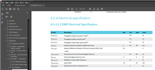

case about nRF52820 COMP precision with mode "CROSS event on VIN+ and VIN- crossing"
1. Please provide the COMP input voltage precision in CROSS event on VIN+ and VIN- crossing mode
2. When the input voltage changes to the minimum, the output terminal will change
Thank you for all your assistance.
Peter.Min
  • Hello Peter.Min,
    Do I understand you correctly that the issue you are seeing is that the CROSS event is generated anytime the voltage goes above 0 V, regardless of the threshold you have set?
    If so, I suspect that your configuration of the COMP peripheral might be the issue.
    Could you show me how you have configured your COMP peripheral, and elaborate on which levels you had intended for it to trigger on?
    Karl
  • Hi Karl Ylvisaker,
    You should understand the question as described below
    First I set CPMP to work in differential mode
    Then I tested that when the input voltage changes by 0.1mV, the output will change.
    Based on the above Settings and tests, I would like to know the following questions
    COMP input voltage accuracy?
    Peter.Min
  • Hello again Peter.Min,
    With no hysteresis enabled and with the differential configuration it is simply a comparator comparing the two signals - the output will change immediately upon a change in the voltage exceeding the other pin. If your signal fluctuates it may therefore trigger a barrage of events as it approaches the threshold if you do not have hysteresis enabled.
    Karl
    This response is very useful to the customer.
    Thank you very much.
