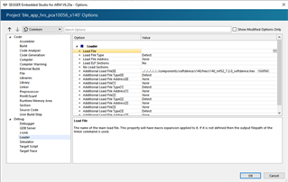

    As you suggested I have copied the PCA10056 > S140 folder from other projects and by comparing I made the required changes in the above folder and it got built successfully. But whenever nrf_sdh_ble_enable() function executes from ble_stack_init() function.  it throws error "<error> app: Fatal error". If you want I can explain what changes I have made to create the PCA10056 > S140 folder.

    I belive this is because of incorrect flash setting. So I have tried to change Linker > Section Placement Macros >But the problem still remains. My Current  Section Placement Macros  is as follows:
    FLASH_PH_START=0x0
    FLASH_PH_SIZE=0x100000
    RAM_PH_START=0x20000000
    RAM_PH_SIZE=0x40000
    FLASH_START=0x27000
    FLASH_SIZE=0xd9000
    RAM_START=0x200018d8
    RAM_SIZE=0x3e728
    Please check if this is correct.

    I did one thing. It was known that it works on PCA10040 > S132 folder as mentioned above. So I opened project PCA10040 > S132 and copied below 2 lines from Section Placement Macros from S132 and used it in the PCA10056 > S140 folder. And it works fine now.
    RAM_START=0x20005968
    RAM_SIZE=0xa698
    Let me know, is this correct way to do so?
