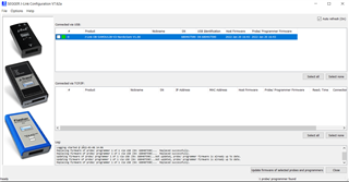

I am using the nRF51 Dongle to connect via a third party app to a measuring device. This always worked very well on my first computer, the app could detect the dongle, scan for bluetooth devices and then connect to the measuring device. However, while setting up the third party app on a different computer, I accidentally updated the firmware of the device to version "2022 Jan 20 16:43" as seen in the picture below in the J-Link Configuration (unfortunately I do not know the old version). All the threads which have a similar problem, are solved with dead links to older firmware. Is there a possibility to roll back to some later version of the firmware? If yes, how can I do so?

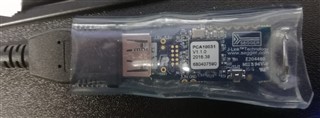

    What does your nRF51 dongle look like? Does it have a PCA number (on a sticker somewhere on the dongle)?

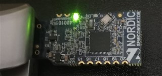

  • Hi, thanks for your fast response. It is not the same FW anymore and as it is the only thing I change between when it was working and when it stopped working I assumed that must be the problem. The PCA is 10031 and that's how it looks like:

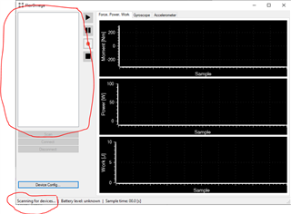

  • Ah sorry then I did not understand you correctly. We do not have any application on the nRF we only use it as a Bluetooth "antenna". The third party windows app was able to detect Bluetooth devices when the dongle was plugged in to the computer. Please see the picture below. I could click on "Scan" and then after a few seconds in the upper left white rectangle a lot of devices could be seen, however after the firmware update it stays blank and it only says "scanning for devices". The app is however still able to detect the nRF as the Scan button only gets released when the program is "connected" to the dongle.
  • I updated the firmware using the app J-Link Configurator V7.62a. I am really sorry when I cannot answer all your questions. Where can I see which hardware is installed on which chip (I unfortunately never flashed something on the chip by myself and my knowledge of the architecture of the dongle is also very minimal).

    If not, can you please try to find out whether the pc application that you are using (screenshot) is programming the nRF, or if it expects the nRF to already be programmed with a certain firmware?

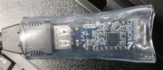

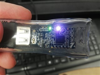

    Thank you very much! I just now got a brand new dongle (of the shelf) and this one works. The program should not program the dongle as far as I know.  I figure however that there are two different applications installed on the dongle because on the brand new dongle there are two LEDs which are lighting up, but on the old one which is NOT working, there is only one green LED that is lighting up (see pictures attached). I have also attached the working and non working FW as you wished and I also tried to flash the old one with the working firmware, however it still doesn't work (sorry that I assumed that it was the firmware before).
    When I connected the new dongle to the computer, I saw two pop-up windows: one about a new firmware update and the second one about that the dongle is in secure mode and that the memory has to be "unlocked", but if you do so something gets erased (sorry I cannot remember the original message). For the brand new dongle I clicked NO for both pop ups, but I think for the one that is not working anymore, I clicked Yes for "unlocking" the memory. Maybe that erased the factory application? Is there a way to set back the dongle to factory settings?

    (FYI: The green LED is probably for the debug chip, and the blue/purple LED is controlled by the applciation on the nRF chip.)
