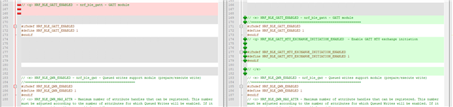

    For example here is some of the changes I can find when doing comparison in Notepad++:
    I have seen the issue "sdk_config.h: "Unable to parse file" before it's usually due to invalid syntax in the sdk_config.h file, or sometime with a wrong end of line symbol. If you do a compare (to the example you based your sdk_config.h on )you can also find where the potential bug is.
