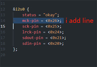

how to enable MCLK pin in NCS1.9.1 for I2S?
hello,
NCS1.9.1,  Windows10 X64,nRF5340-DK,nrfx_i2s
in file boards\nrf5340dk_nrf5340_cpuapp.overlay
i've i2s DAC model ,it must use 4 line(MCLK,SCLK,SDIN,LRCK)
but default config no MCLK pin set,i add mck-pin,it not work.
how to enable MCLK pin?
thanks
Best Regards
    Could I see your prj.conf file, and how you are enabling the i2s peripheral in your code?
    thanks for reply,  the file prj.conf
    i add [mck-pin = <0x26>;] to file boards\nrf5340dk_nrf5340_cpuapp.overlay
    i2s is master mode,i do't know how to enable MCLK.

  • 	nrfx_i2s_config_t config =NRFX_I2S_DEFAULT_CONFIG(I2S_SCK_PIN, I2S_LRCK_PIN,
    								NRFX_I2S_PIN_NOT_USED,I2S_SDOUT_PIN, I2S_SDIN_PIN);
    Here you need to replace NRFX_I2S_PIN_NOT_USED with the MCK pin. If you don't already have a I2S_MCK_PIN, just define it the same way for example I2S_SCK_PIN is defined.
    thanks a lot, i'm sorry,
    how could I not have noticed this line!
