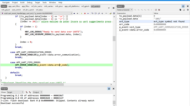

  • after doing debug test with the new module I get the same problem I had before: communication error at the time when a value is sent from the master (my Stm8), I attach the screen with the watches active during debugging

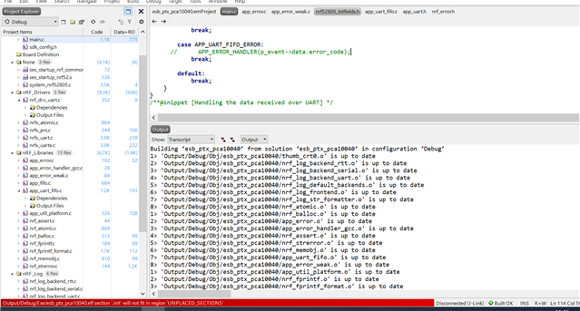

    trying to understand what problem there was I came to this : nrf_error.h that reports a No_Mem error as a value of 4. Searching on your online support I found this ticket: link which proposed a test: comment on the lines of error handling code to see what was happening. The problem arose after making this change to the code now I can no longer compile (see photo below)
  • maybe it is better to bring the project back with the old settings?
    This is from the ERRORSRC register, that UART have detected a framing error.
    "A valid stop bit is not detected on the serial data input after all bits in a character have been received."
    Commenting out this single line of code shouldn’t generate this error. Could you upload the project?

  • Sigurd said:
    "Non viene rilevato un bit di stop valido sull'input di dati seriali dopo che tutti i bit in un carattere sono stati ricevuti."
    how do I know which final character is valid, I send an array with the value and a final '/'

    Commentare questa singola riga di codice non dovrebbe generare questo errore. Potresti caricare il progetto?
    the compilation problem has been solved
