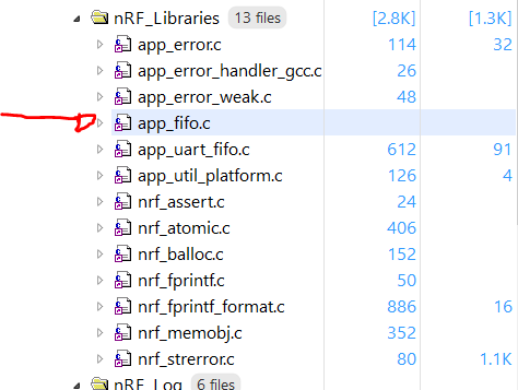

  • Thank you,I entered the missing part of the code, but now build the project returns an error trying to compile the single file instead does not happen. The libraries required by the file.c are all imported correctly
    C:/Program Files/SEGGER/SEGGER Embedded Studio for ARM 5.44/gcc/arm-none-eabi/bin/ld: Output/Release/Obj/esb_ptx_pca10040/app_uart_fifo.o: in function `uart_event_handler':
    1> [my path] \nRF5_SDK_17.0.2_d674dde\components\libraries\uart/app_uart_fifo.c:119: undefined reference to `app_fifo_get'
    1> C:/Program Files/SEGGER/SEGGER Embedded Studio for ARM 5.44/gcc/arm-none-eabi/bin/ld: [my path]\nRF5_SDK_17.0.2_d674dde\components\libraries\uart/app_uart_fifo.c:83: undefined reference to `app_fifo_put'
    1> C:/Program Files/SEGGER/SEGGER Embedded Studio for ARM 5.44/gcc/arm-none-eabi/bin/ld: Output/Release/Obj/esb_ptx_pca10040/app_uart_fifo.o: in function `app_uart_init':
    1> [my path]\nRF5_SDK_17.0.2_d674dde\components\libraries\uart/app_uart_fifo.c:152: undefined reference to `app_fifo_init'
    1> C:/Program Files/SEGGER/SEGGER Embedded Studio for ARM 5.44/gcc/arm-none-eabi/bin/ld: [my path]\nRF5_SDK_17.0.2_d674dde\components\libraries\uart/app_uart_fifo.c:156: undefined reference to `app_fifo_init'
    1> C:/Program Files/SEGGER/SEGGER Embedded Studio for ARM 5.44/gcc/arm-none-eabi/bin/ld: Output/Release/Obj/esb_ptx_pca10040/app_uart_fifo.o: in function `app_uart_get':
    1> [my path]\nRF5_SDK_17.0.2_d674dde\components\libraries\uart/app_uart_fifo.c:205: undefined reference to `app_fifo_get'

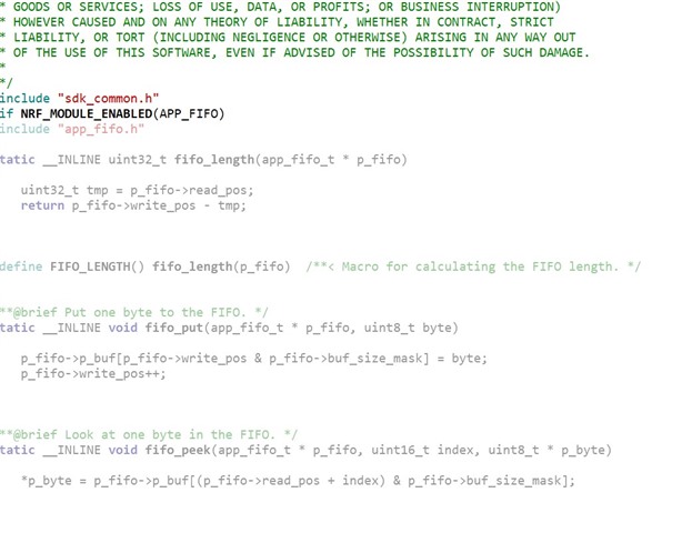

  • the file has been inserted but inside the text is all cleared as if it did not find the define of the file.h but in the preprocessor the folder that contains the.h file is inserted
    if I click on the NRF_MODULE_ENABLED(APP_FIFO) function and I click "go to definition" takes me to the file nordic_common.h and not to app_fifo.h
  • I see, yes, you need this in sdk_config.h
    // <q> APP_FIFO_ENABLED  - app_fifo - Software FIFO implementation
    #ifndef APP_FIFO_ENABLED
    #define APP_FIFO_ENABLED 1
