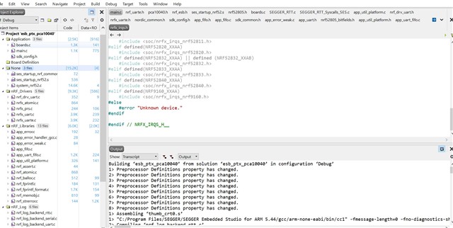

    I still tried to compile after doing the first 3 steps listed but I have an error and it crashes the compilation for completeness the project works in this way : stm8 sends on uart to nrf52 in turn nrf52 sends to another nrf52 (remote device) the same data received. I can not currently answer the questions you asked me because I can not know if after the changes you proposed the situation changes
    What is the error?
  • the files to be replaced where do I find them?
    for the define ok I delete it.
    the error is this :
