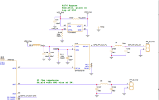

&lt;p&gt;&lt;span&gt;Kazi Afroza Sultana&lt;/span&gt;&lt;/p&gt;&lt;div style="clear:both;"&gt;&lt;/div&gt;</description></item><item><title>RE: GNSS, configuration of the XCOEX0 for GPS and LTE</title><link>https://devzone.nordicsemi.com/thread/367238?ContentTypeID=1</link><pubDate>Tue, 10 May 2022 15:24:26 GMT</pubDate><guid isPermaLink="false">137ad170-7792-4731-bb38-c0d22fbe4515:f5e4be53-7009-46a4-8b46-ebb317d6d6f4</guid><dc:creator>Stas Jis</dc:creator><description>&lt;p&gt;&lt;a class="internal-link view-user-profile" href="https://devzone.nordicsemi.com/members/kazi-afroza-sultana"&gt;Kazi Afroza Sultana&lt;/a&gt;,&lt;br /&gt;My question:&lt;br /&gt;First, we used LNA just for GPS. LNA enable is connected to COEX0 should we you just next configuration?&lt;br /&gt;AT%XCOEX0=1,1,1570,1580&lt;br /&gt;In addition how the nRF MCU knows the current frequences range when we sending the data over LTE? It&amp;#39;s manage internally inside the MCU or we need to apply additional configuration and set LTE &amp;amp; GPS frequences and then according to the type of the LTE or GPS activation MCU choose state of COEX0 PIN.&amp;nbsp;&lt;br /&gt;&lt;br /&gt;&lt;img src="https://devzone.nordicsemi.com/resized-image/__size/320x240/__key/communityserver-discussions-components-files/4/pastedimage1652196250329v1.png" alt=" " /&gt;&lt;br /&gt;&lt;br /&gt;&lt;br /&gt;&lt;br /&gt;&lt;/p&gt;&lt;div style="clear:both;"&gt;&lt;/div&gt;</description></item><item><title>RE: GNSS, configuration of the XCOEX0 for GPS and LTE</title><link>https://devzone.nordicsemi.com/thread/366995?ContentTypeID=1</link><pubDate>Mon, 09 May 2022 14:24:45 GMT</pubDate><guid isPermaLink="false">137ad170-7792-4731-bb38-c0d22fbe4515:d3f5415b-06f5-4479-a445-0f17f2ecaff3</guid><dc:creator>Kazi Afroza Sultana</dc:creator><description>&lt;p&gt;Hello,&lt;/p&gt;
&lt;p&gt;What is your pin numbers for both of these antenna ports (LTE and GPS)? Here you can find the pin assignment&amp;nbsp;&lt;a href="https://infocenter.nordicsemi.com/topic/ps_nrf9160/pin.html?cp=2_0_0_9_0"&gt;https://infocenter.nordicsemi.com/topic/ps_nrf9160/pin.html?cp=2_0_0_9_0&lt;/a&gt;&amp;nbsp;. You should know what kind of control you need for the hardware. You can send us the schematic of your schematic board.&lt;/p&gt;
&lt;p&gt;&amp;nbsp;AT command output shows that you got good range for GPS ( 1570 -1580) since GPS is universal.&amp;nbsp;&lt;/p&gt;
