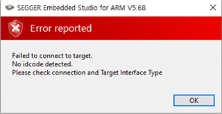

<?xml-stylesheet type="text/xsl" href="https://devzone.nordicsemi.com/cfs-file/__key/system/syndication/rss.xsl" media="screen"?><rss version="2.0" xmlns:dc="http://purl.org/dc/elements/1.1/" xmlns:slash="http://purl.org/rss/1.0/modules/slash/" xmlns:wfw="http://wellformedweb.org/CommentAPI/" xmlns:atom="http://www.w3.org/2005/Atom"><channel><title>Upload code to external nrf52832 chip</title><link>https://devzone.nordicsemi.com/f/nordic-q-a/87756/upload-code-to-external-nrf52832-chip</link><description>Hi, I want to upload the code to external nrf52832 chip(which is on the custom-made PCB) using nrf52DK board.
 First, I tried to check uploading the nrf52832 chip on nrf52DK board (nrf52DK-to-nrf52DK) using nrf52DK board following the figure below. </description><dc:language>en-US</dc:language><generator>Telligent Community 13</generator><lastBuildDate>Wed, 11 May 2022 11:36:30 GMT</lastBuildDate><atom:link rel="self" type="application/rss+xml" href="https://devzone.nordicsemi.com/f/nordic-q-a/87756/upload-code-to-external-nrf52832-chip" /><item><title>RE: Upload code to external nrf52832 chip</title><link>https://devzone.nordicsemi.com/thread/367383?ContentTypeID=1</link><pubDate>Wed, 11 May 2022 11:36:30 GMT</pubDate><guid isPermaLink="false">137ad170-7792-4731-bb38-c0d22fbe4515:60fb0029-2a97-48a4-80f1-83fa1d554c2c</guid><dc:creator>Simonr</dc:creator><description>&lt;p&gt;Hi, most parts aren&amp;#39;t necessary, but it&amp;#39;s recommended to mount decoupling and VDD capacitors, and the DCDC components (if applicable) so the current flows as intended. Stuff like the external crystals shouldn&amp;#39;t be necessary to mount.&lt;/p&gt;

&lt;p&gt;Simon&lt;/p&gt;&lt;div style="clear:both;"&gt;&lt;/div&gt;</description></item><item><title>RE: Upload code to external nrf52832 chip</title><link>https://devzone.nordicsemi.com/thread/367286?ContentTypeID=1</link><pubDate>Wed, 11 May 2022 06:06:34 GMT</pubDate><guid isPermaLink="false">137ad170-7792-4731-bb38-c0d22fbe4515:309fb37b-0ee3-4acd-90ad-d1756703b67e</guid><dc:creator>Chulyoon Jung</dc:creator><description>&lt;p&gt;As far as I know, programming adapter don&amp;#39;t have any other parts, and it can be used to upload the code.&lt;/p&gt;
&lt;p&gt;So I thought the other parts are not necessary only to upload the code.&lt;/p&gt;
&lt;p&gt;&lt;span&gt;Is there anything wrong with my idea?&lt;/span&gt;&lt;/p&gt;

&lt;p&gt;Yes, you also need to assemble the other parts on your custom board so the nRF52832 is able to run normally before you program it.&amp;nbsp;&lt;/p&gt;
