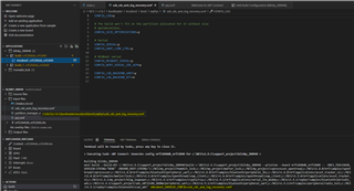

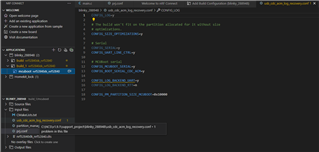

<?xml-stylesheet type="text/xsl" href="https://devzone.nordicsemi.com/cfs-file/__key/system/syndication/rss.xsl" media="screen"?><rss version="2.0" xmlns:dc="http://purl.org/dc/elements/1.1/" xmlns:slash="http://purl.org/rss/1.0/modules/slash/" xmlns:wfw="http://wellformedweb.org/CommentAPI/" xmlns:atom="http://www.w3.org/2005/Atom"><channel><title>How to apply a .conf file to a child build process in Visual Code Studio</title><link>https://devzone.nordicsemi.com/f/nordic-q-a/87842/how-to-apply-a-conf-file-to-a-child-build-process-in-visual-code-studio</link><description>Uns NCS v1.9.1 and VSC, I am attempting to run through the Device Firmware Update (DFU) with MCUBoot bootloader exercise.
 I am running to a road black in figuring out how to apply a .config file to the mcuboot child application as described in step</description><dc:language>en-US</dc:language><generator>Telligent Community 13</generator><lastBuildDate>Sat, 21 May 2022 04:21:11 GMT</lastBuildDate><atom:link rel="self" type="application/rss+xml" href="https://devzone.nordicsemi.com/f/nordic-q-a/87842/how-to-apply-a-conf-file-to-a-child-build-process-in-visual-code-studio" /><item><title>RE: How to apply a .conf file to a child build process in Visual Code Studio</title><link>https://devzone.nordicsemi.com/thread/368882?ContentTypeID=1</link><pubDate>Sat, 21 May 2022 04:21:11 GMT</pubDate><guid isPermaLink="false">137ad170-7792-4731-bb38-c0d22fbe4515:664e882a-45d7-4957-92d9-66d1fdee3d29</guid><dc:creator>Jeff4BLE</dc:creator><description>&lt;p&gt;Thank you&lt;/p&gt;&lt;div style="clear:both;"&gt;&lt;/div&gt;</description></item><item><title>RE: How to apply a .conf file to a child build process in Visual Code Studio</title><link>https://devzone.nordicsemi.com/thread/367633?ContentTypeID=1</link><pubDate>Thu, 12 May 2022 13:04:09 GMT</pubDate><guid isPermaLink="false">137ad170-7792-4731-bb38-c0d22fbe4515:f0d34701-9413-4e0d-8008-931c2afd524a</guid><dc:creator>Amanda Hsieh</dc:creator><description>&lt;p&gt;Hi Jeff,&amp;nbsp;&lt;/p&gt;
&lt;p&gt;You can set with the&amp;nbsp;Extra CMake arguments, see &lt;a href="https://nrfconnect.github.io/vscode-nrf-connect/connect/build_app.html?h=extra+cmake+arguments#setting-up-a-build-configuration"&gt;Setting up a build configuration&lt;/a&gt;&amp;nbsp;doc. Without the given path to usb_cdc_acm_log_recovery.conf, it will source bootloader\mcuboot\boot\zephyr\usb_cdc_acm_log_recovery.conf&lt;/p&gt;
