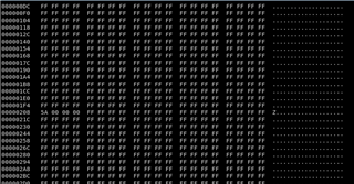

&lt;p&gt;&lt;pre class="ui-code" data-mode="text"&gt;halt
w4 4001E504, 2
w4 4001e50C, 1
r&lt;/pre&gt;&lt;/p&gt;
&lt;p&gt;We will see subsequently that indeed there&amp;#39;s 0xFF written to the register at 0x10001208.&lt;/p&gt;
&lt;p&gt;&lt;img alt=" " src="https://devzone.nordicsemi.com/resized-image/__size/320x240/__key/communityserver-discussions-components-files/4/pastedimage1652708716228v2.png" /&gt;&lt;/p&gt;
&lt;p&gt;After nrfjprog --recover we will find that this UICR value is overwritten by the Nordic tool to 0x5A.&lt;/p&gt;
&lt;p&gt;&lt;img alt=" " src="https://devzone.nordicsemi.com/resized-image/__size/320x240/__key/communityserver-discussions-components-files/4/pastedimage1652708647502v1.png" /&gt;&lt;/p&gt;
&lt;p&gt;Hence, hereby clarifying what happens.&lt;/p&gt;
&lt;p&gt;&lt;/p&gt;
&lt;p&gt;@Nordic. Would you mind to add an option to nrfjprog to leave this register alone? Perhaps something like nrfjprog --someoption that erases everything WITHOUT writing to this field. For example, also e.g. nrfjprog --eraseall writes this register.&lt;/p&gt;&lt;div style="clear:both;"&gt;&lt;/div&gt;</description></item><item><title>RE: UICR won't be completely erased (APPROTECT)</title><link>https://devzone.nordicsemi.com/thread/367677?ContentTypeID=1</link><pubDate>Thu, 12 May 2022 14:22:17 GMT</pubDate><guid isPermaLink="false">137ad170-7792-4731-bb38-c0d22fbe4515:5c70b58d-5a27-47fc-9240-940b77c40c7b</guid><dc:creator>Anne van Rossum</dc:creator><description>&lt;p&gt;Ah, good to know. I actually started to suspect nrfjprog indeed to do such a thing. As far as I know it&amp;#39;s not open source, pity!&lt;/p&gt;

&lt;p&gt;The nrfjprog tool will identify the revision and handle them slightly differently due to this, e.g. on rev2 the UICR.APPROTECT likely will be set to 0xFF (disabled), while on rev3 it likely will be set to 0x5A (disabled) when using --recover option.&amp;nbsp;&lt;/p&gt;
&lt;p&gt;Also be aware that there are two APPROTECT registers, one in UICR (&lt;a href="https://infocenter.nordicsemi.com/topic/ps_nrf52840/uicr.html#register.APPROTECT"&gt;https://infocenter.nordicsemi.com/topic/ps_nrf52840/uicr.html#register.APPROTECT&lt;/a&gt;) and one in RAM (&lt;a href="https://infocenter.nordicsemi.com/topic/ps_nrf52840/dif.html#topic"&gt;https://infocenter.nordicsemi.com/topic/ps_nrf52840/dif.html#topic&lt;/a&gt;).&lt;/p&gt;

&lt;p&gt;This was true on the earlier chip revisions, but unfortunately it no longer applies on the latest silicon.&lt;/p&gt;
&lt;p&gt;EDIT: Ok, protection is removed by an erase, but it won&amp;#39;t stay that way after a reset unless you do the required actions.&lt;/p&gt;
&lt;p&gt;(Removed some of what I wrote because it may have been incorrect.)&lt;/p&gt;
&lt;p&gt;This new revision is simply different. You can&amp;#39;t make it behave like the old one.&lt;/p&gt;&lt;div style="clear:both;"&gt;&lt;/div&gt;</description></item><item><title>RE: UICR won't be completely erased (APPROTECT)</title><link>https://devzone.nordicsemi.com/thread/367665?ContentTypeID=1</link><pubDate>Thu, 12 May 2022 13:59:27 GMT</pubDate><guid isPermaLink="false">137ad170-7792-4731-bb38-c0d22fbe4515:dcc3251b-52e5-4ab8-8893-c25aa4094d03</guid><dc:creator>Anne van Rossum</dc:creator><description>&lt;p&gt;Mmm, clicked on the vote thing by accident... I can&amp;#39;t undo it, but I don&amp;#39;t want to vote it up either. :-D&lt;/p&gt;&lt;div style="clear:both;"&gt;&lt;/div&gt;</description></item><item><title>RE: UICR won't be completely erased (APPROTECT)</title><link>https://devzone.nordicsemi.com/thread/367663?ContentTypeID=1</link><pubDate>Thu, 12 May 2022 13:57:44 GMT</pubDate><guid isPermaLink="false">137ad170-7792-4731-bb38-c0d22fbe4515:5c71deb2-bd11-4640-a654-dc7c15a12ac4</guid><dc:creator>Anne van Rossum</dc:creator><description>&lt;p&gt;It doesn&amp;#39;t truly make sense what you say. The readback protection is removed on --recover just because 0xFF gets written to those registers. And I&amp;#39;m not talking about enabling it. Just read my question.&lt;/p&gt;&lt;div style="clear:both;"&gt;&lt;/div&gt;</description></item><item><title>RE: UICR won't be completely erased (APPROTECT)</title><link>https://devzone.nordicsemi.com/thread/367662?ContentTypeID=1</link><pubDate>Thu, 12 May 2022 13:54:11 GMT</pubDate><guid isPermaLink="false">137ad170-7792-4731-bb38-c0d22fbe4515:eb4aafaa-6fb9-4b5f-8e72-7ded53000946</guid><dc:creator>Anne van Rossum</dc:creator><description>&lt;p&gt;On the PCA10056 I just have 0xFF in APPROTECT. No, 0x5A&lt;/p&gt;

&lt;p&gt;I think I understand what&amp;#39;s happening, namely that the nrfjprog tool automatically writes 0x5A towards that register after a recover operation.&lt;/p&gt;
&lt;p&gt;And of course I&amp;#39;ve read the documentation as well &lt;a href="https://devzone.nordicsemi.com/nordic/nordic-blog/b/blog/posts/working-with-the-nrf52-series-improved-approtect"&gt;https://devzone.nordicsemi.com/nordic/nordic-blog/b/blog/posts/working-with-the-nrf52-series-improved-approtect&lt;/a&gt; and no, I just don&amp;#39;t want to do protection in firmware.&lt;/p&gt;
&lt;p&gt;If someone wants to glitch the thing, go ahead. Our code is open source and not locked down to begin with. So everything making flashing more cumbersome is to be removed from the process. I don&amp;#39;t want this stuff to be suddenly interfering with our flash tools in the factory depending if there has been or has not been a power cycle in that process.&lt;/p&gt;&lt;div style="clear:both;"&gt;&lt;/div&gt;</description></item><item><title>RE: UICR won't be completely erased (APPROTECT)</title><link>https://devzone.nordicsemi.com/thread/367598?ContentTypeID=1</link><pubDate>Thu, 12 May 2022 12:12:37 GMT</pubDate><guid isPermaLink="false">137ad170-7792-4731-bb38-c0d22fbe4515:f4a26fa5-dd39-496a-809b-7cb34cd01340</guid><dc:creator>mrono</dc:creator><description>&lt;p&gt;Well, improved in the sense that it is not as easily bypassed I guess.&lt;/p&gt;
[quote userid="3223" url="~/f/nordic-q-a/87846/uicr-won-t-be-completely-erased-approtect/367592#367592"]Apart from that, let&amp;#39;s just assume I want to write 0xFF rather than 0x5A there. Can I do this?[/quote]
&lt;p&gt;I suppose, but then it would still be locked, I think.&lt;/p&gt;
&lt;p&gt;You need the firmware on the device to also write some magic words to keep the device &amp;#39;unlocked&amp;#39;.&lt;/p&gt;
&lt;p&gt;This is copied from the guide I linked above:&lt;/p&gt;
&lt;p&gt;&lt;span&gt;1. Start with a CTRL-AP ERASEALL operation.&lt;/span&gt;&lt;br /&gt;&lt;span&gt;2. Program code compiled with an MDK 8.44.1 or later,&amp;nbsp;&lt;/span&gt;&lt;strong&gt;without&lt;/strong&gt;&lt;span&gt;&amp;nbsp;ENABLE_APPROTECT defined.&lt;/span&gt;&lt;br /&gt;&lt;span&gt;3. Write HwDisabled (0x5A) to UICR.APPROTECT&lt;/span&gt;&lt;br /&gt;&lt;span&gt;4. Perform any reset to run the code. The programmed code from step 2 will open access port by writing to APPROTECT.DISABLE during start-up.&lt;/span&gt;&lt;/p&gt;
