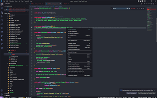

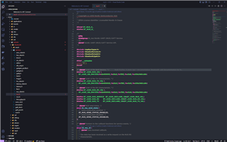

&lt;p&gt;Neither F12 nor ctrl-shift-F find the definitions I&amp;#39;m seeking.&lt;/p&gt;&lt;div style="clear:both;"&gt;&lt;/div&gt;</description></item><item><title>RE: Global searching in nRF Connect 1.9 VS</title><link>https://devzone.nordicsemi.com/thread/369185?ContentTypeID=1</link><pubDate>Tue, 24 May 2022 07:36:24 GMT</pubDate><guid isPermaLink="false">137ad170-7792-4731-bb38-c0d22fbe4515:14d2c023-01c5-4357-9b40-fec25acbff26</guid><dc:creator>JONATHAN LL</dc:creator><description>&lt;p&gt;You can use the &amp;quot;go to definition&amp;quot; feature to find the definition of any C, devicetree or Kconfig symbol. You can also search for all symbols by pressing Ctrl+T (works for any language), or Ctrl+Shift+O for the current file.&lt;br /&gt;&lt;br /&gt;If you open the entire NCS folder in VS code then you should be able to use the &amp;quot;go to definition&amp;quot; function(hotkey F12)&lt;br /&gt;&lt;img src="https://devzone.nordicsemi.com/resized-image/__size/320x240/__key/communityserver-discussions-components-files/4/pastedimage1653376641938v1.png" alt=" " /&gt;&lt;br /&gt;Here I have opened the entire NCS folder and using the F12 works as expected.&amp;nbsp;&lt;br /&gt;&lt;br /&gt;It is also possible to add the SDK to a workspace, its called multi root workspaces.:&amp;nbsp;&lt;a href="https://code.visualstudio.com/docs/editor/multi-root-workspaces"&gt;https://code.visualstudio.com/docs/editor/multi-root-workspaces&lt;/a&gt;&amp;nbsp;&lt;br /&gt;&lt;br /&gt;Using a NCS project you can also use the command&amp;nbsp; &amp;quot;nRF Connect: Add nRF Connect SDK to workspace&amp;quot; to make it pull in the right one as a workspace folder.&lt;br /&gt;&lt;br /&gt;Some documentation here:&lt;a href="https://nrfconnect.github.io/vscode-nrf-connect/connect/create_app.html"&gt;https://nrfconnect.github.io/vscode-nrf-connect/connect/create_app.html&lt;/a&gt;&amp;nbsp;&lt;br /&gt;&lt;br /&gt;&lt;br /&gt;CRTL + F only searches in the current file you are in, use CTRL + SHIFT + F to search everything in your workspace.&amp;nbsp;&lt;br /&gt;&lt;br /&gt;&lt;br /&gt;Regards,&lt;br /&gt;Jonathan&lt;/p&gt;&lt;div style="clear:both;"&gt;&lt;/div&gt;</description></item><item><title>RE: Global searching in nRF Connect 1.9 VS</title><link>https://devzone.nordicsemi.com/thread/369085?ContentTypeID=1</link><pubDate>Mon, 23 May 2022 14:37:43 GMT</pubDate><guid isPermaLink="false">137ad170-7792-4731-bb38-c0d22fbe4515:b34742fb-e13e-4275-9d94-e212a9f9bc9a</guid><dc:creator>SteveHx</dc:creator><description>&lt;p&gt;&lt;span style="color:#000000;"&gt;I have and use nRF Connect but I have no idea where to find the screen you show. My immediate issue (but I want to learn to fish, not just get a fish) is finding the definition of BT_UUID_NUS_SERVICE. Hovering the mouse over it shows the definition as &lt;span class="mtk15"&gt;BT_UUID_DECLARE_128&lt;/span&gt;&lt;span class="mtk1"&gt;(BT_UUID_NUS_VAL), but neither of those items are searchable with the usual ctrlF search.&lt;br /&gt;&lt;/span&gt;&lt;/span&gt;&lt;/p&gt;

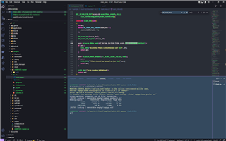

&lt;p&gt;&lt;span class="mtk1" style="color:#d4d4d4;"&gt;&lt;/span&gt;&lt;/p&gt;&lt;div style="clear:both;"&gt;&lt;/div&gt;</description></item><item><title>RE: Global searching in nRF Connect 1.9 VS</title><link>https://devzone.nordicsemi.com/thread/368677?ContentTypeID=1</link><pubDate>Thu, 19 May 2022 16:38:17 GMT</pubDate><guid isPermaLink="false">137ad170-7792-4731-bb38-c0d22fbe4515:9ba7ebbf-b590-4502-8836-6f1a2c981b22</guid><dc:creator>JONATHAN LL</dc:creator><description>&lt;p&gt;Hi,&lt;br /&gt;&lt;br /&gt;I belive you can open the project with the nRF Connect &lt;span&gt;&amp;nbsp;&lt;/span&gt;&lt;span&gt;extension&lt;/span&gt;, so when you open the SDK through the Toolchain manager you select from the home page or side bar of the nRF Connect extension.&amp;nbsp;&lt;br /&gt;&lt;br /&gt;&lt;img src="https://devzone.nordicsemi.com/resized-image/__size/320x240/__key/communityserver-discussions-components-files/4/pastedimage1652978100306v1.png" alt=" " /&gt;&lt;br /&gt;&lt;br /&gt;Select the create or open existing option and the project you want to work with. Then go to definition (F12) should get you to the corrected file where it is defined.&amp;nbsp;&lt;br /&gt;&lt;br /&gt;Regards,&lt;br /&gt;Jonathan&lt;/p&gt;&lt;div style="clear:both;"&gt;&lt;/div&gt;</description></item><item><title>RE: Global searching in nRF Connect 1.9 VS</title><link>https://devzone.nordicsemi.com/thread/368655?ContentTypeID=1</link><pubDate>Thu, 19 May 2022 14:24:32 GMT</pubDate><guid isPermaLink="false">137ad170-7792-4731-bb38-c0d22fbe4515:667a7808-e96d-4864-af34-5da34af4c72b</guid><dc:creator>SteveHx</dc:creator><description>&lt;p&gt;Hello?.....Hello?? Is anyone here?&lt;/p&gt;&lt;div style="clear:both;"&gt;&lt;/div&gt;</description></item><item><title>RE: Global searching in nRF Connect 1.9 VS</title><link>https://devzone.nordicsemi.com/thread/368399?ContentTypeID=1</link><pubDate>Wed, 18 May 2022 13:58:32 GMT</pubDate><guid isPermaLink="false">137ad170-7792-4731-bb38-c0d22fbe4515:5d4c8e2d-c0eb-4414-a45f-35c6a5238c8a</guid><dc:creator>SteveHx</dc:creator><description>&lt;p&gt;Still standing by here. Both issues are becoming urgent.&lt;/p&gt;&lt;div style="clear:both;"&gt;&lt;/div&gt;</description></item><item><title>RE: Global searching in nRF Connect 1.9 VS</title><link>https://devzone.nordicsemi.com/thread/368111?ContentTypeID=1</link><pubDate>Mon, 16 May 2022 18:33:39 GMT</pubDate><guid isPermaLink="false">137ad170-7792-4731-bb38-c0d22fbe4515:7903c59f-2db3-433d-b845-11c2ea68d99c</guid><dc:creator>SteveHx</dc:creator><description>&lt;p&gt;I see no way in Toolchain Manager to open a project directly. Once VS is open, I do &amp;lt;File&amp;gt;&amp;lt;OpenFolder&amp;gt; and point to the folder where the project was unzipped.&lt;/p&gt;
&lt;p&gt;There are really two issues here. The second will also resolve the first, but maybe not as quickly:&lt;/p&gt;
&lt;p&gt;1) I need to find where the value used for the UUID is actually created, so as to be able to modify it for a specific project.&lt;/p&gt;
&lt;p&gt;2) I need to learn how to do a general search of the project (like ctrl-shitf-F in SES) for any particular string. Clearly in the present case the project and thereby the compiler knows about all the files included, but the search isn&amp;#39;t finding them.&lt;/p&gt;&lt;div style="clear:both;"&gt;&lt;/div&gt;</description></item><item><title>RE: Global searching in nRF Connect 1.9 VS</title><link>https://devzone.nordicsemi.com/thread/368108?ContentTypeID=1</link><pubDate>Mon, 16 May 2022 18:09:25 GMT</pubDate><guid isPermaLink="false">137ad170-7792-4731-bb38-c0d22fbe4515:d7897f44-f34f-4bee-9966-e40bff81b0b7</guid><dc:creator>JONATHAN LL</dc:creator><description>&lt;p&gt;Hi,&lt;br /&gt;&lt;br /&gt;How do you open the project, are you using the toolchain manager an opening a project through there? Or are you suing the VS code exactions on their own ?&lt;br /&gt;&lt;br /&gt;Regards,&lt;br /&gt;Jonathan&lt;/p&gt;&lt;div style="clear:both;"&gt;&lt;/div&gt;</description></item></channel></rss>
