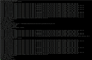

 I have program two nRF52833, one as transmitter and one as receiver (with zephyr project called &amp;quot;direction_finding_connectionless_tx&amp;quot; and &amp;quot;direction_finding_connectionless_tx&amp;quot;). I have an antenna array with 4 antenna patch.
 But i have a problem</description><dc:language>en-US</dc:language><generator>Telligent Community 13</generator><lastBuildDate>Fri, 20 May 2022 10:27:21 GMT</lastBuildDate><atom:link rel="self" type="application/rss+xml" href="https://devzone.nordicsemi.com/f/nordic-q-a/88067/direction-finding-aoa-with-nrf52833" /><item><title>RE: Direction finding AOA with nRF52833</title><link>https://devzone.nordicsemi.com/thread/368792?ContentTypeID=1</link><pubDate>Fri, 20 May 2022 10:27:21 GMT</pubDate><guid isPermaLink="false">137ad170-7792-4731-bb38-c0d22fbe4515:cd9fa6b9-76ed-4727-a5d5-925ad4a11c84</guid><dc:creator>Simonr</dc:creator><description>&lt;p&gt;Hi&lt;/p&gt;

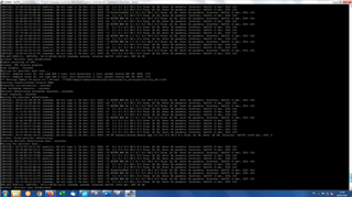

&lt;p&gt;I&amp;#39;m afraid the screenshots you have uploaded are too low of a resolution for me to read properly. Could you upload them as logs instead perhaps?&amp;nbsp;&lt;/p&gt;
&lt;p&gt;Please note that the output you see from these samples won&amp;#39;t be the &amp;quot;finished&amp;quot; angle of arrival, as this just transmits the raw IQ data to your central device. It is up to you to add an AoA algorithm that handles these values and converts them into readable data.&amp;nbsp;&lt;span&gt;Nordic will not provide the direction finding algorithm, and customers/users are expected to get that elsewhere. I&lt;/span&gt;&lt;span&gt;n order to use the IQ data you get from the beacon you will need an AOA algorithm, which we don&amp;#39;t provide.&amp;nbsp;&lt;/span&gt;&lt;span&gt;There is no point in looking at the raw data as it needs to be converted into vector form to review it properly. You can check out&amp;nbsp;&lt;/span&gt;&lt;a href="https://www.pe0sat.vgnet.nl/sdr/iq-data-explained/"&gt;this page&lt;/a&gt;&lt;span&gt;&amp;nbsp;for information on the various formulas used to translate IQ data between polar and rectangular form.&amp;nbsp;&lt;/span&gt;&lt;/p&gt;
&lt;p&gt;It&amp;#39;s also worth noting that an antenna array with only 4 antennas in total will not provide great accuracy, and we recommend 12 or more antennas in an array for good accuracy.&lt;/p&gt;
