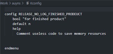

<?xml-stylesheet type="text/xsl" href="https://devzone.nordicsemi.com/cfs-file/__key/system/syndication/rss.xsl" media="screen"?><rss version="2.0" xmlns:dc="http://purl.org/dc/elements/1.1/" xmlns:slash="http://purl.org/rss/1.0/modules/slash/" xmlns:wfw="http://wellformedweb.org/CommentAPI/" xmlns:atom="http://www.w3.org/2005/Atom"><channel><title>NCS how to add  custom configuration to prj.conf?</title><link>https://devzone.nordicsemi.com/f/nordic-q-a/88172/ncs-how-to-add-custom-configuration-to-prj-conf</link><description>Hi,
 NCS1.9.99, vscode, nRF5340,
 i want add custom configuration to prj.conf,
 RELEASE_NO_LOG_FINISHED_PRODEUCT=y
 but got error
 Best regards</description><dc:language>en-US</dc:language><generator>Telligent Community 13</generator><lastBuildDate>Tue, 24 May 2022 08:22:38 GMT</lastBuildDate><atom:link rel="self" type="application/rss+xml" href="https://devzone.nordicsemi.com/f/nordic-q-a/88172/ncs-how-to-add-custom-configuration-to-prj-conf" /><item><title>RE: NCS how to add  custom configuration to prj.conf?</title><link>https://devzone.nordicsemi.com/thread/369205?ContentTypeID=1</link><pubDate>Tue, 24 May 2022 08:22:38 GMT</pubDate><guid isPermaLink="false">137ad170-7792-4731-bb38-c0d22fbe4515:5209b969-4bc1-44dd-9f9d-102f3132689f</guid><dc:creator>yoyou</dc:creator><description>&lt;p&gt;thanks&amp;nbsp;&lt;/p&gt;

&lt;p&gt;You must set CONFIG_RELEASE_NO_LOG_FINISHED_PRODEUCT=y in prj.conf, with CONFIG_ before the name of the configuration.&lt;/p&gt;
