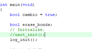

&lt;p&gt;yes, sure&amp;nbsp;&lt;/p&gt;
&lt;p&gt;when I comment uart_init in my application, don&amp;#39;t works , but dont shows a specific error&lt;/p&gt;
&lt;p&gt;&lt;img src="https://devzone.nordicsemi.com/resized-image/__size/320x240/__key/communityserver-discussions-components-files/4/pastedimage1654874752171v1.png" alt=" " /&gt;&lt;/p&gt;

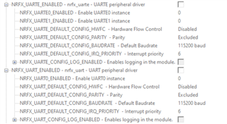

&lt;p&gt;&amp;nbsp;sdk_config is disabled uarte, and i dont have a problem abaut this&lt;/p&gt;
&lt;p&gt;&lt;img src="https://devzone.nordicsemi.com/resized-image/__size/320x240/__key/communityserver-discussions-components-files/4/pastedimage1654875068801v2.png" alt=" " /&gt;&lt;/p&gt;

&lt;p&gt;i comented all about uart_init&lt;/p&gt;

&lt;p&gt;&lt;span&gt;i comented&amp;nbsp;&lt;/span&gt;&lt;/p&gt;
&lt;p&gt;&lt;span&gt;uart_init&lt;/span&gt;&lt;/p&gt;
&lt;p&gt;&lt;span&gt;uart_event_handle&lt;/span&gt;&lt;/p&gt;

&lt;p&gt;Aah ok,&amp;nbsp; you right, I disabled&amp;nbsp; uart, from sdk_config, And now I have low&amp;nbsp; consumption,&amp;nbsp;&lt;/p&gt;
