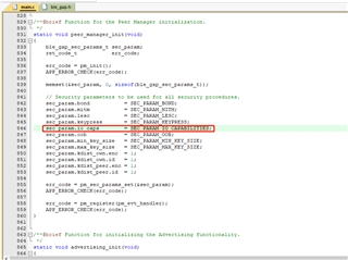

&lt;p&gt;Is the point that you want to support only pairing but not bonding so that pairing has to be done again on every reconnection (including passkey entry if that is used)? If so you should set&amp;nbsp;&lt;code&gt;CONFIG_BT_BONDABLE=n&lt;/code&gt;.&lt;/p&gt;&lt;div style="clear:both;"&gt;&lt;/div&gt;</description></item><item><title>RE: BLE Authentication</title><link>https://devzone.nordicsemi.com/thread/369674?ContentTypeID=1</link><pubDate>Thu, 26 May 2022 13:41:06 GMT</pubDate><guid isPermaLink="false">137ad170-7792-4731-bb38-c0d22fbe4515:cbd18b81-e6b8-4d76-82bc-9d1d487bec3b</guid><dc:creator>Tom Nowak</dc:creator><description>&lt;p&gt;I think your answer uses nrf5 but unfortunately I am using nrf Connect SDK v1.9.1 - I should have specified in prompt.&lt;/p&gt;&lt;div style="clear:both;"&gt;&lt;/div&gt;</description></item><item><title>RE: BLE Authentication</title><link>https://devzone.nordicsemi.com/thread/369638?ContentTypeID=1</link><pubDate>Thu, 26 May 2022 02:31:20 GMT</pubDate><guid isPermaLink="false">137ad170-7792-4731-bb38-c0d22fbe4515:e8678051-ff18-4552-814e-41a55231884e</guid><dc:creator>RFstar_Sunny</dc:creator><description>&lt;p&gt;Hi Tom,&lt;br /&gt;&lt;br /&gt;Based on&amp;nbsp;my&amp;nbsp;development&amp;nbsp;experience, I recommend modifying the IO settings&amp;nbsp;related to the bonding.&lt;/p&gt;
&lt;p&gt;&lt;img src="https://devzone.nordicsemi.com/resized-image/__size/320x240/__key/communityserver-discussions-components-files/4/pastedimage1653532135666v1.png" alt=" " /&gt;&lt;/p&gt;&lt;div style="clear:both;"&gt;&lt;/div&gt;</description></item></channel></rss>
