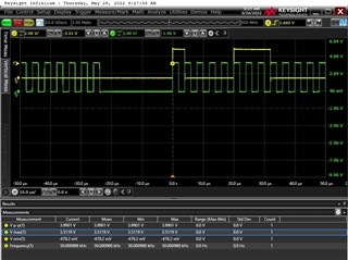

 I try to write and read data by SPIM0.
 Wirte works find but when read data oscilloscope like this.
 But, receive buffer data is like this.
 temp_rx_buf[0] = 0x87 is correct value. 1000 0111

&lt;p&gt;I solved this problem to setting spim mode in spim configuration.&lt;br /&gt;NRF_SPIM_MODE_0 to&amp;nbsp;NRF_SPIM_MODE_1.&lt;/p&gt;&lt;div style="clear:both;"&gt;&lt;/div&gt;</description></item><item><title>RE: SPIM Recevie data is allways 1bit right shift</title><link>https://devzone.nordicsemi.com/thread/369740?ContentTypeID=1</link><pubDate>Fri, 27 May 2022 09:29:42 GMT</pubDate><guid isPermaLink="false">137ad170-7792-4731-bb38-c0d22fbe4515:2ce30e23-0054-4d6b-be2c-977bb9053bf6</guid><dc:creator>J&amp;#248;rgen Holmefjord</dc:creator><description>&lt;p&gt;Hi,&lt;/p&gt;
&lt;p&gt;Is the SPIM0 configured using the same SPI mode (see Table 2 in&amp;nbsp;&lt;a title="Pin configuration" href="https://infocenter.nordicsemi.com/topic/ps_nrf52833/spim.html?cp=4_1_0_5_22_2#concept_v4x_5w2_wr"&gt;Pin configuration&lt;/a&gt;), as supported by the SPI slave device you are interfacing?&lt;/p&gt;
&lt;p&gt;What slave device are you interfacing?&lt;/p&gt;
&lt;p&gt;Can you post your SPIM configuration and code for performing transactions?&lt;/p&gt;
