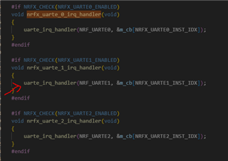

 Our custom setup includes another development board say DK3 (based on</description><dc:language>en-US</dc:language><generator>Telligent Community 13</generator><lastBuildDate>Fri, 03 Jun 2022 12:03:20 GMT</lastBuildDate><atom:link rel="self" type="application/rss+xml" href="https://devzone.nordicsemi.com/f/nordic-q-a/88335/uart-handler-in-server-light-side-isn-t-getting-called" /><item><title>RE: UART handler in Server light side isn't getting called</title><link>https://devzone.nordicsemi.com/thread/370872?ContentTypeID=1</link><pubDate>Fri, 03 Jun 2022 12:03:20 GMT</pubDate><guid isPermaLink="false">137ad170-7792-4731-bb38-c0d22fbe4515:03e3e7e7-c7c6-4aad-a330-76e666b738fe</guid><dc:creator>Simon</dc:creator><description>&lt;p&gt;It&amp;#39;s a long time since I&amp;#39;ve worked with the nRF5 SDK (I work mostly with the nRF Connect SDK), but I will do my best to help.&lt;/p&gt;
&lt;p&gt;Can you try 2 things:&lt;/p&gt;
&lt;ul&gt;
&lt;li&gt;Connect a logic analyzer to the UART lines, and check if you see any activity&lt;/li&gt;
&lt;li&gt;&lt;a href="https://www.youtube.com/watch?v=uP8RYgYGRvI&amp;amp;list=PLx_tBuQ_KSqGHmzdEL2GWEOeix-S5rgTV&amp;amp;index=7"&gt;Debug your application&lt;/a&gt;, and&amp;nbsp;in&amp;nbsp;nRF5_SDK_17.1.0\modules\nrfx\drivers\src\nrfx_uarte.c, set a break point inside at nrfx_uarte_x_irq_handler, for example if you use uart1, set a break point as shown below:&lt;/li&gt;
&lt;/ul&gt;
&lt;p&gt;&lt;img src="https://devzone.nordicsemi.com/resized-image/__size/320x240/__key/communityserver-discussions-components-files/4/3125.pastedimage1654257687742v1.png" alt=" " /&gt;&lt;/p&gt;
&lt;p&gt;Check out this case as well&amp;nbsp;&lt;a href="https://devzone.nordicsemi.com/f/nordic-q-a/30097/uart_event_handle-method-doesnt-called-to-send-a-string"&gt;https://devzone.nordicsemi.com/f/nordic-q-a/30097/uart_event_handle-method-doesnt-called-to-send-a-string&lt;/a&gt;&amp;nbsp;&lt;/p&gt;
