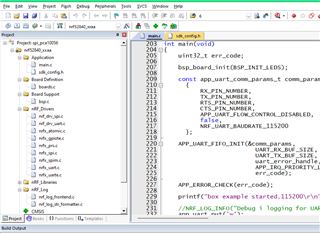

<?xml-stylesheet type="text/xsl" href="https://devzone.nordicsemi.com/cfs-file/__key/system/syndication/rss.xsl" media="screen"?><rss version="2.0" xmlns:dc="http://purl.org/dc/elements/1.1/" xmlns:slash="http://purl.org/rss/1.0/modules/slash/" xmlns:wfw="http://wellformedweb.org/CommentAPI/" xmlns:atom="http://www.w3.org/2005/Atom"><channel><title>SDK17.2 uart no log</title><link>https://devzone.nordicsemi.com/f/nordic-q-a/88664/sdk17-2-uart-no-log</link><description>Hello,
 SDK17.2,keil5, nRF21540-DK
 the uart can&amp;#39;t log output, i&amp;#39;ve no idea.
 PS: \nRF5_SDK_17.0.2_d674dde\examples\peripheral\uart\ can got uart log

&lt;p&gt;Please check if you added retarget.c into your project.&amp;nbsp;&lt;/p&gt;&lt;div style="clear:both;"&gt;&lt;/div&gt;</description></item></channel></rss>
