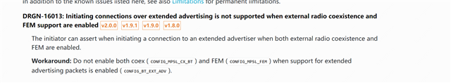

 I use NCS 1.9.1 test Advertising Extensions,I have a problem.
 I use softdevice controller,if I not set &amp;quot;CONFIG_BT_LL_SW_SPLIT=y&amp;quot;,the program will be report :opcode 0x2036 status 0x11 ，bt_le_ext_adv_create err:-5.
 if i set </description><dc:language>en-US</dc:language><generator>Telligent Community 13</generator><lastBuildDate>Tue, 07 Jun 2022 12:20:40 GMT</lastBuildDate><atom:link rel="self" type="application/rss+xml" href="https://devzone.nordicsemi.com/f/nordic-q-a/88677/advertising-extensions-problem" /><item><title>RE: Advertising Extensions problem</title><link>https://devzone.nordicsemi.com/thread/371134?ContentTypeID=1</link><pubDate>Tue, 07 Jun 2022 12:20:40 GMT</pubDate><guid isPermaLink="false">137ad170-7792-4731-bb38-c0d22fbe4515:5b574a52-7899-49c2-b8ee-6b8363a8676d</guid><dc:creator>Edvin</dc:creator><description>&lt;p&gt;Hello,&lt;/p&gt;
&lt;p&gt;If you are not using FEM, then I don&amp;#39;t think that the DRGN-16013 is actually what you are seeing.&amp;nbsp;&lt;/p&gt;
